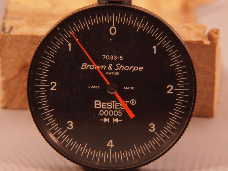

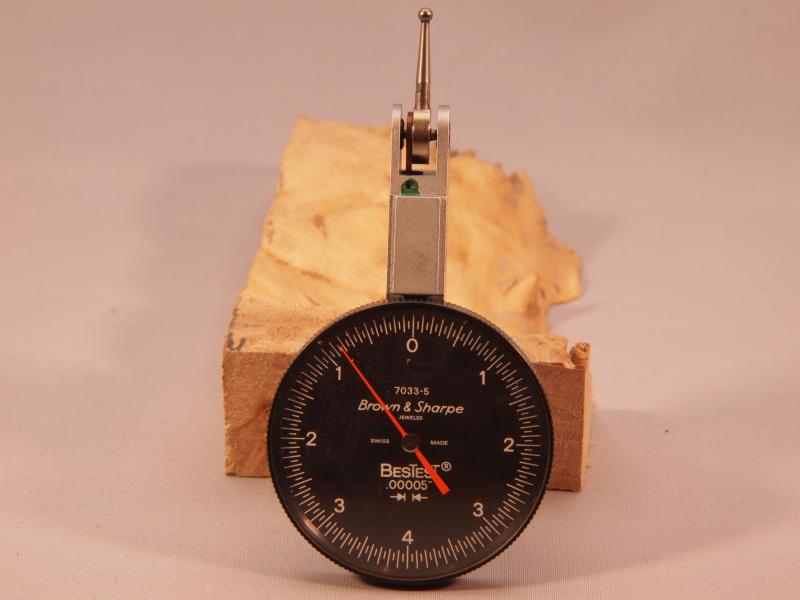

Thought you guys with the DRO on your lathes, would get a kick out of this.
This is one of 4 indicators I use when I work on Close tollerance Mold parts.
Yes your reading that dial right.. Thats 5 decimal places This is a 50 Millionths of an inch (.00005") indicator, each number is .001" so this only reads .008" total .004" on each side of zero.
These kind of tollerences are measured in controlled inspection room, and I have to have them callibrated every year.
Nope I don't use it on my Pens.... :wink:

1/500,000th of a millimeter is a little closer than I measure...... By an inch or two.
Danny, who makes this DI?
It's a Brown and Sharp, I have a couple of them the other's I have are SPI and Mitutyo, I've had them for years. I'm not sure Brown and Sharp make test indicators any more.
It would be nice to have digital stuff, but since I don't plan on keeping this shop that long, the old way will work just fine (it did for 20 years) :wink:
They still work fine, I just had to get the calibration certs updated: part of the contract with this customer, is that I supply copies of calibration certs that show the inspection and measurement equipment we use is reading correctly.

Yep, it's one of the test indicators I use to check my parts when I'm grinding them to finish dim.
I use a set of high precision gage blocks set to my dim then use the test indicator to check how close I am and how much I have to grind off (hopefully it's take off :wink:). all this inspection is done on a pink rock (mold maker lingo for a high precision surface plate)

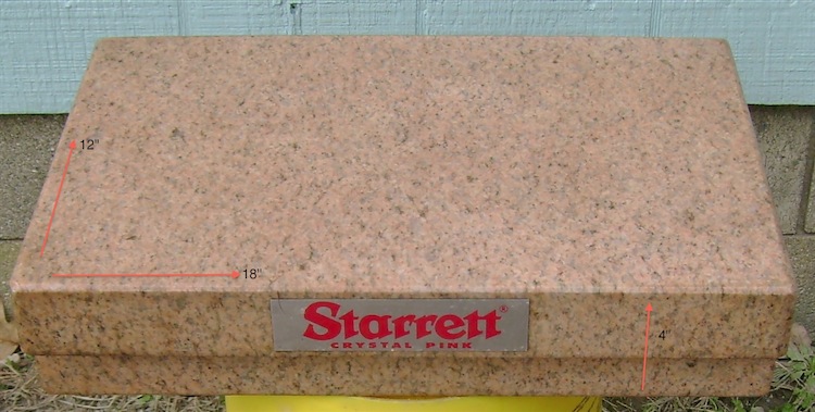

Wow, what are the specs on the pink rock that is used to spec? Then, what are the specs for the machine that specs them.....:befuddled::hypnotized::question::bulgy-eyes:
I know the B grade they can come in inspect them in the shop and resurface them there; these are black granite and close enough for 99% of what we do, we have a 36" x 48" one in the shop.
The AA grade we have to send out, and they are usally made of pink granite (never seen an AA that was not pink). I have two of these that are mine (Not the Shops) 18" x 24" and 24" x 24" two ledge.
I'm attaching a PDF I just found.
  • Tolerances_for_Surface_Plates.pdf

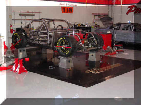

Here ya go Pictures:
A surface plate, and building a race car on a big surface plate. :)

Just to add a point, anytime you go to these kind of dimensions .0000x", or even .000x" unless your equipment is in a industry standard controlled environment then saying you can hold them because your DRO has that display really isnt true. Right on!
Temperture change can move a part quite a bit depending on what type of material it is.
The grinders I work with are in a controlled environment, and even the slightest bit of temperture change (like grinding) can move the part out of tollerances, it's not as easy as reading the number on a DRO, (which the grinders I use do have), this is why we constantly have to check the parts (take them off the grinders, let then stabilize and put them on the surface table), not only do we have to hold the dimension, we also have to hold the centerlines, squareness, flatness, and position to the cavity.
I find it odd, that me just showing a test indicator that is not digital readout (Which I thought some would get a kick out of), has become an agurement in symantics as such. Thanks for posting the picture. I compare it to a couple of mine that only go to "hundreds of millionths."
With respect to the grinding comment - I've experienced temperature problems quite often because of the localized heating. This is especially true when grinding dry but still can manifest itself with flood coolant. The handwheel on the surface grinder is graduated in tenths (of thousandths) but sometimes even a second or third pass to "spark out" the surface at the same depth will run into what I'll call "temperature bumps" from earlier passes.
What's all that got to do with pens? I use this kind of equipment to make tooling to hold pen parts and to make tooling to make tooling. It never ends. I also use the surface grinder to mate Damascus slab surfaces for reforging.

If the measurement gage, pin, DRO, dial is made properly then it can measure or indicate more "precision" than another with lesser quality or fewer graduations. These dial indicators (Danny's) will measure relative precision to some calibrated error around the tick mark on the dial face (that's why Danny has them calibrated once a year). But, you're right in one respect in that you can't just add tick marks and expect additional measurement precision. The capability has to be inherent in the manufactured quality of the indicator.
By the way, if you didn't know, measurements of this tiny a value are in the realm of the wavelength of near-infrared light. Any more precision gets into optical measurement technology never mind the environment required. Purely academic for what's made here.
