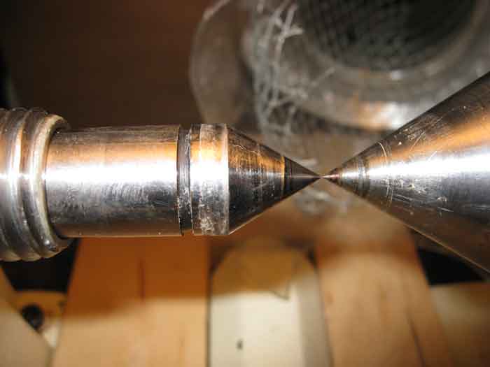

Have you checked the alignment of the headstock to the tailstock by bringing the centers together and seeing how accurately they meet?
Is there any side to side play in the tailstock or does it lock down in the same position each time?

The head and tail stocks align perfectly.
