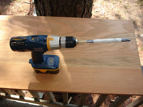

I use a hand held drill with the same grits I use on the outside, and plastic polish to finish it off. Like this:
