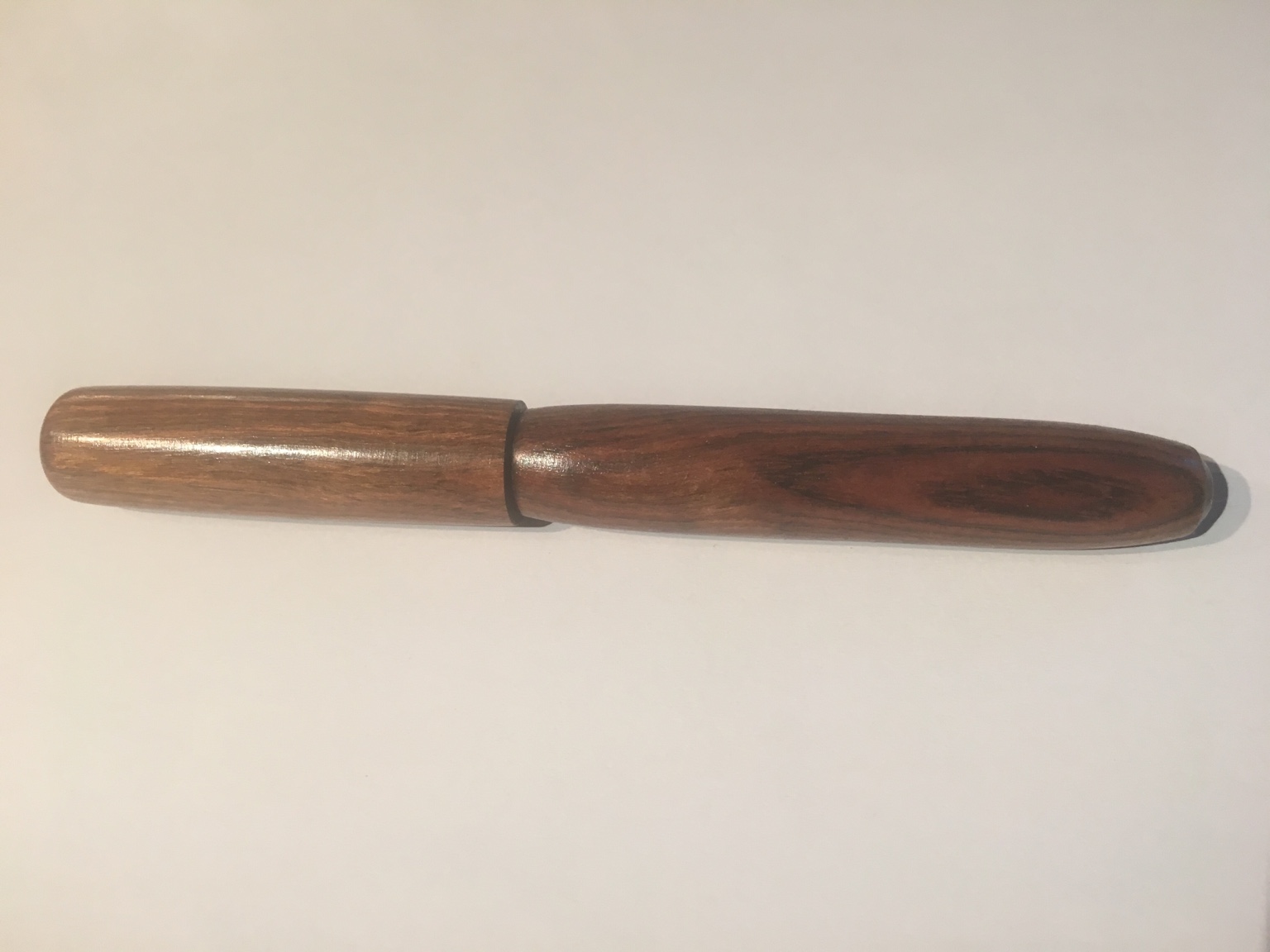

I've done a Zen kit without tubes. Just glued the ends to the wood. I was concerned drilling the drum stick I used to the brass OD so I drilled to the tube ID.
That is pretty nice looking. I am guessing then you only drilled deep enough to accept the components and then drilled a center hole to accept the refill??? Am I correct in this??? What glue did you use to glue the parts in with?? Thanks for showing
After rereading your post I now do not understand your thinking. If you drilled the blank to the inside measurements as opposed to outside we are talking what a step up in size of bit. It would be such a small difference and you left the blank proud of the components any way which gave it more meat to compensate. I would think a drum stick is a pretty strong piece of wood. I maybe missing something here.

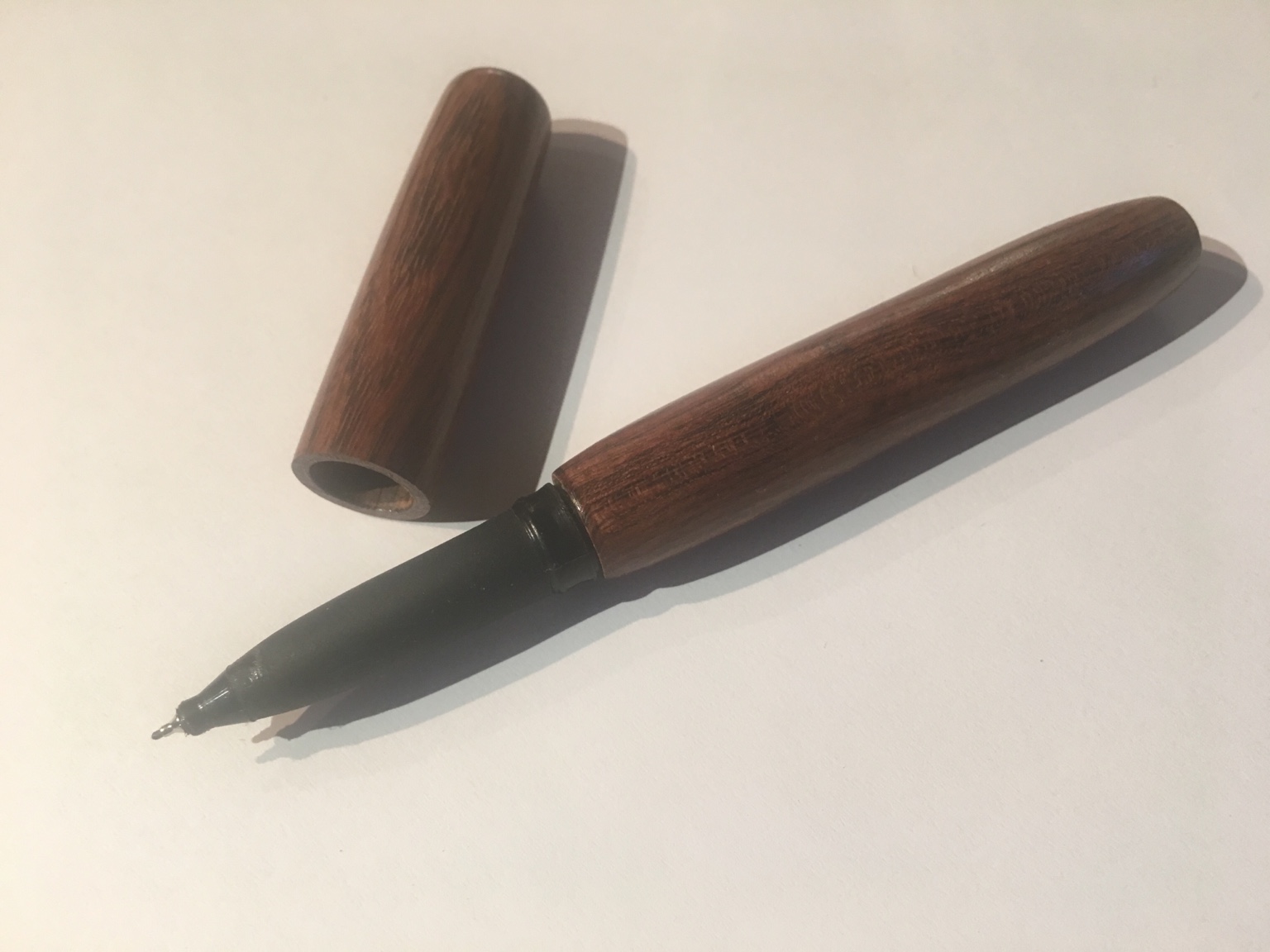

Sure! Here's a "kitless" I did recently for a Sharpie pen refill in Chechen. No tubes, but as it's already been mentioned, the tubes give them structural integrity, like a skeleton. This pen was just a quick project to scratch an itch I had, but the lack of tubes gave me issues. I had to practically soak the body in CA at one point due to cracking.
It is possible and this one is holding up well for now, but it isn't as sturdy or durable as it could have been with some brass or something inside. While I'm fairly pleased with this little experiment, I won't do it the same way next time. That's the beauty of it. It's your creation, try anything and everything once. You'll likely learn something along the way.
