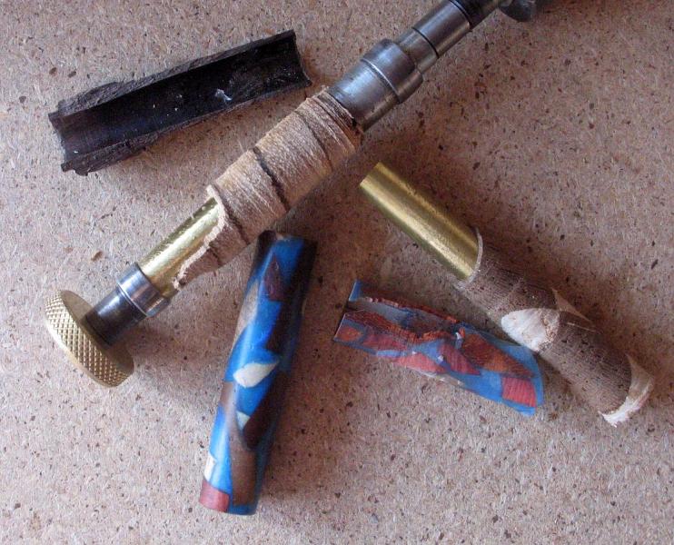

Is pretty much what Ive been having the past three weeks.
At first the turning went well, no worries, then about three weeks ago almost everything I turned from wood to acrylic would just blow out.
Obviously segmented was the worst but it even happened sanding at 1200 grit right at the end so it was obviously not just isolated to one action.
I found a couple of guys who have turned pens and picked their brains. The response echoed two problems -
1. My lathe speed is incorrect.
2. Tools are not sharp enough (or incorrectly sharpened)
My lathe runs at 2500 rpm. The tools are clearly a problem and one that is easily fixable.
My questions are hence the following -
1. What speed should my lathe be turning at?
2. What tools are recommended? (HSS/carbide tipped etc)
3. At what angle should tools be sharpened at?
Im currently resorting to sanding the blank down almost completely on the sander and then just rounding the blank on the lathe and then sanding. This works well on softer woods (kiaat)but the minute I go to anything remotely harder it blows out.
Now I must mention that I have turned acrylics with no problem in the past as well as the harder woods like rose/walnut etc
Any and all help would be most appreciated.
Cheers
Terry
Ps. Attached photo of a few of the blow outs - had a total of nine consecutive which I'm sure is some kind of record :frown:

I would say this could have alot to do with how much pressure you are using as well as the angle you are holding your tools. Ride the bevel and lower the tool with light cuts. And yes, they need to stay sharp as well. Do you have a grinder? Are you sharpening your tools?

One reason not mentioned for blow outs is thightening the mandrel to tight. As the blank gets thinner they will crack and let go. If you are not getting a catch and the blank blows this might be the problem.

My first thought was the Mandrel is too tight. After reading comments, I still think that may be the problem. I'd also check, just to do it, if the mandrel is straight and not bent.

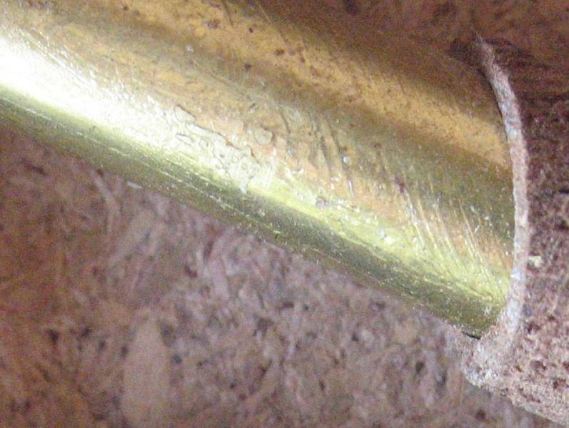

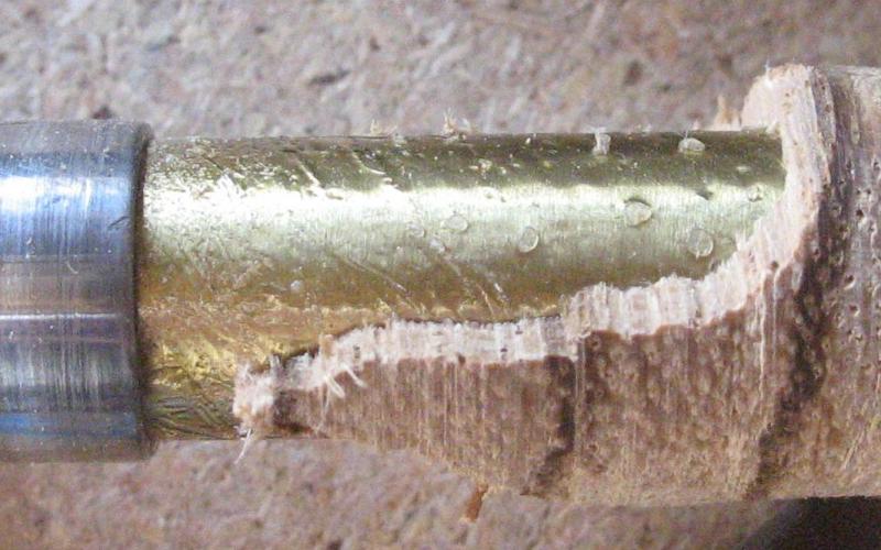

Terry, what glue are you using?
The bond between the brass tube and the wood needs to be strong and I do not see any glue on the tubes in your photo of the blowouts. They look bright and shinny.
After looking closely at your photo I think your glue method is the fault.
It looks like the wood is adsorbing what ever glue you are using leaving very little to bond the wood to the brass tube.
Try the polyurethane glue (Gorilla Glue) as it will expand and fill any voids.
I am reasonably sure the glue is your problem but here are some other suggestions ...
Tool pressure, tool angle of attack, sharpness, these could be causing the blowouts also.

IMO, looking at your blowouts, I suspect simply not having sharp tools and applying to much pressure on the blanks to achieve the cut. Find the best way for you to sharpen and practice that first.

heres some enlargements of the first pics - cropped to show close-ups of the tubes. In the one pic you can actually see how Ive turned the tube when inserting.
if Im doing it incorrectly or there is a better method, please feel free to correct me.

Looking at the wood blank that blew out, were you turning cross-grain? 99% of the time if I get a blowout it is when I am turning cross-grain wood. Certain open grain woods are almost impossible to turn cross grain. (That doesn't address the acrylic problem, I know.) The very first time I tried making segmented blanks I used wenge and lauan....both very open grain woods, and they were cross grain to maximize figure. Blew out EVERY TIME I tried to turn one. A good hard heartwood blank usually turns fine crossgrain for me. Turning crossgrain you have to have your tools razor sharp, as well.
