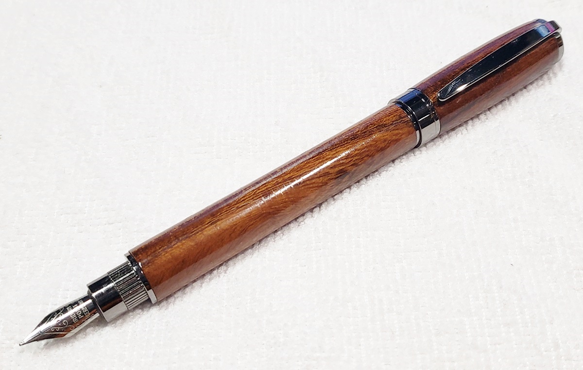

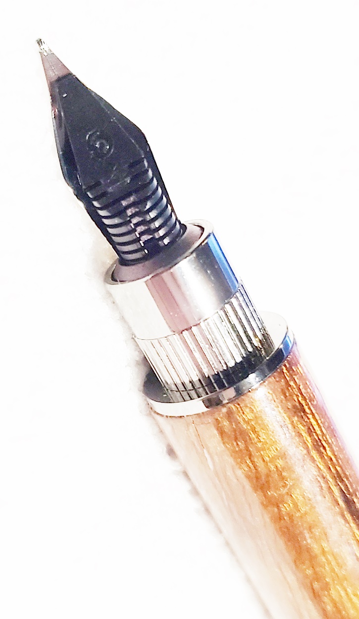

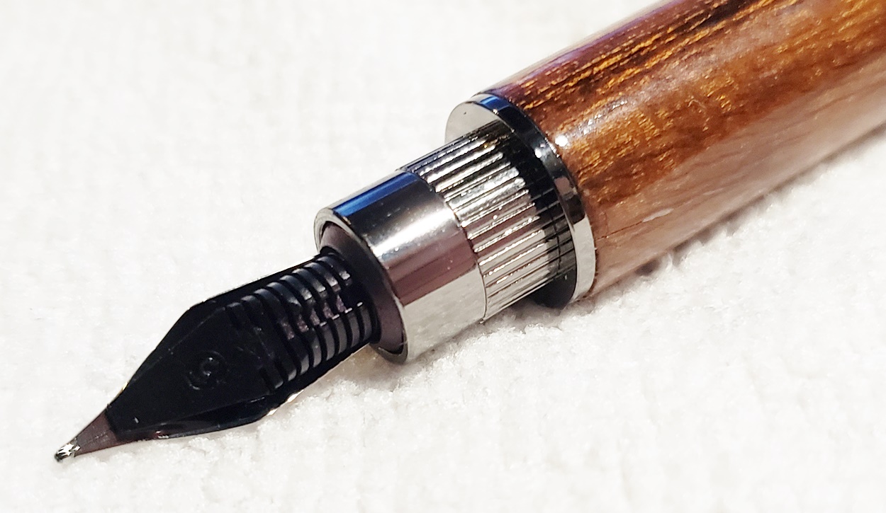

This is a Magnetic Graduate. Does anyone know what size the nib is?

It looks like either a #5 or a #5.5.
#5's are easy to find, the link above to Goulet pens is where I get mine.
I have seen the 5.5's of a few kits. The only place I have seen them available is https://fprevolutionusa.com/. The good news is they are very affordable (less than $5), and I have found them to be very good quality.
Sent from my iPad using Penturners.org mobile app
Check this out: IPG nibs
You can measure the feed diameter to see what size the nib is. A #5 nib fits a 5 mm feed, etc. My cursory search of the intertubes suggests that Penn State is probably the manufacturer of this kit, they should be able to tell you nib specs.
Please let me know if any work. You may want to measure all dimensions and check with the seller. Thank you for the above.
That measurement only applies to very few modern nibs. Namely JoWo and Bock produced nibs. There is no standard association of numbers and nib sizes.
