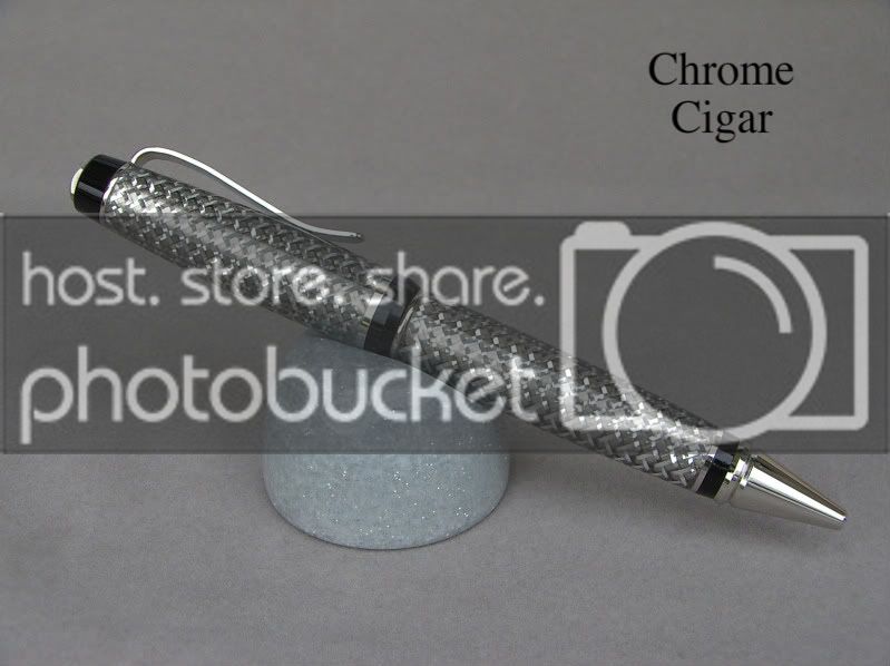

Well this is the next metal in the series of metal sleeved pen blanks. This is a super tough one to photogragh at least for me. I tried both indoor and out and the glare from the chrome is overwhelming the photo. But here it is anyway.
I put it on a chrome cigar kit and also a chrome/satin chrome Elegant Beauty. They do look alot cooler in person. I just gave up on the photo shot. Thanks for looking.
Hey, those are really cool! What exactly is the material you used for the blanks? It looks a lot like the braided hoses, but then again, it doesn't.
No this is not stainless steel braiding. It is a actual chrome sleeving with a clear mylar backing. It is actually a decorative wire sleeving. http://cableorganizer.com/chrome-sleeving/
I get my stainless steel sleeving from them also. The stuff in the home centers on the flexible water pipe is abit thin and when using on larger kits it has a tendency to show the tube so i use the heavier stuff.
Speaking as a photographer, I think your images are simply fantastic...
The pens are stunning to say the least, but I could not think of a better light for them. The highlights accentuate the quality of the finish, and the balance of fall-off does an excellent job of showing the patterning and contrast of the braid. I'm sure you're well aware of the difficulties of photographing such highly reflective items, and your images show it...

John, Those look fantastic, it looks like you've taken the hard part out of the braided hose pens, the Mylar has to be easier to trim to length than the Stainless Braid, and it looks so close. Great work on the Photography as well.
