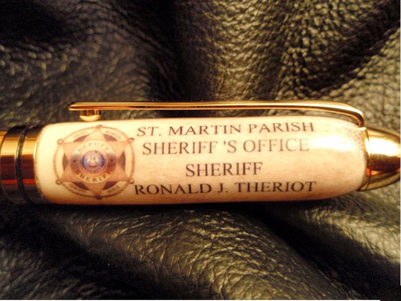

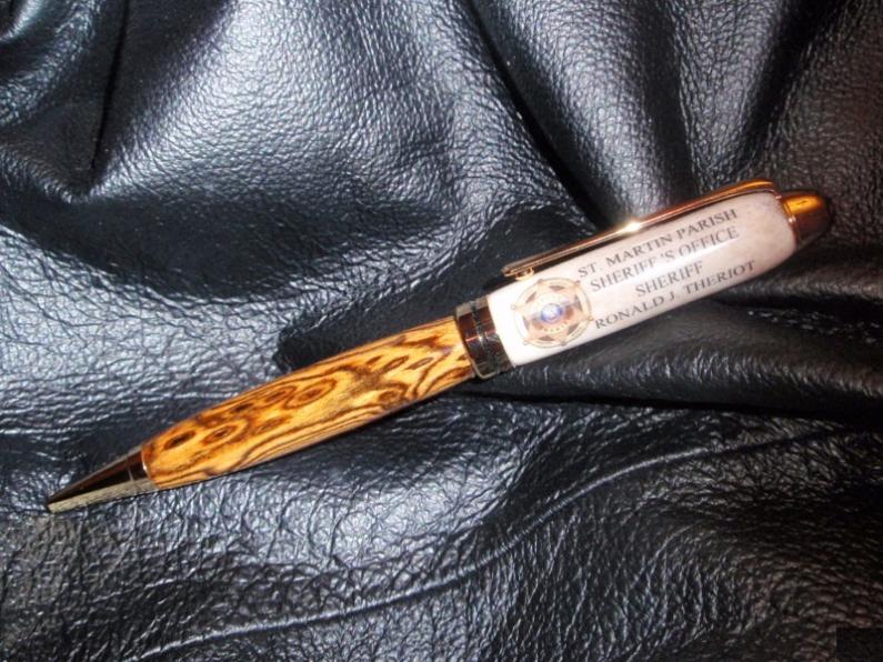

This was my first attempt at using a decal, made it for a friend. The wood is Bocote with deer antler on the top. Sorta anxious to hear opinions :confused:
Thanks,
Chuck
Decal

Jim,
I utilized the decal process located at this link:
http://lumberjocks.com/Kerux/blog/3811
Kerux's process is the process I follow but I have learned a couple things along the way however, so I will share them with you so hopefully you don't repeat my mistakes and loose as I did:
1. The blank can have almost NO curvature AT ALL meaning from the center ring area to the cap as the decals can only bend one way. Try to keep your decals short or short enough to fit on the flat area of the blank. Font or design size will really be determined by the blank size.
2. The blank must be very smooth and shiny before applying the decal. Fill any grain in wood completely with CA before applying the decal.
3. Dark wood will not work well as the ink on the decal is not bright enough to over power the wood color.
4. Do not spray too much clear on your decal sheets or they will be too stiff.
5. Do not spray too little clear on the decals or your ink will rub off while you place it. I typically apply two coats.
6. Printing tips: print in draft format on paper and try it for size before printing on your decal paper, print along the bottom of the page first and work your way up and you will waste less. This way you can use the entire sheet
7. If it appears that the edge of the decal is not completely secured don't put CA on top of it, you will only be disappointed with the finish product, trust me, start over!
8. I use medium CA over the decal and spray accelerant on it each time. Be sure to rub off the residue from the accelerant each time, or you'll be disappointed when the paper towel instantly sticks to your blank, trust me!
9. If you are like me and do not have a printer at home and you are printing them somewhere else, print about five or six of each decal you intend to use or you will go to bed disappointed or you will be making another trip to the office!
10. A printer cannot print white. Areas that appear white on your logo will be whatever color your blank is.
Hope this helps you and as I work to perfect it more I will update this post!
You might want to consider using decal setting solution. It will soften the substrate of the decal and help it conform to almost any surface. Compunds curves won't be much of a problem. I don't know how the setting solutions would react with anything that you spray onto your decal sheets. You can get setting solution at almost any hobby store.
There are two different types of decal paper you can buy. The first is the transparent, which is what you seemed to have used. That will allow the background to show somewhat through the decal. TESTORS also sells decals that have a solid white background that you can print any color and stick on any color wood. It might have a tendency to show more flaws since you have to cut the decal logo carefully. I have usually tried to do logos on simple geometric patterns (on a white circle/square/rectangle, etc) to make it easier but have made more difficult cuts (Harley Davidson logo). You can get on the TESTORS website and order either type of paper though and make sure you order the decal bonder as well. Hope this helps other folks....
I like your method though and have felt your pain MANY times over on trying to get the decal to seal under CA....very frustrating at times. Nice looking pen though...
