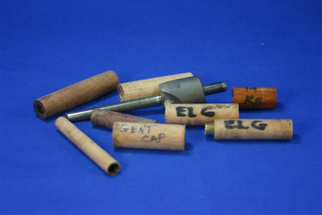

Welcome to the "Learning Curve". We have all been there. One thing that helps with the Sierra style is that there are multiple lengths -- The longest tube is the click that is designed for a Uniball -- That pen can be made as a Parker 'style with the standard sierra tube cut down to 1.882 inches in length (a chipped end or similar problem can be recovered by shortening the body) Then there is the click pencil which is still shorter.
A "aw shucks" twist sierra can become a parker length Click Sierra, or still shorter a
Click Sierra Pencil.
Drill a 7mm hole in a piece of scrap wood. Glue in a spare 7mm tube and put the "blank" on the mandrel and turn it so it just slips inside the sierra tube. The looser the fit the more wiggle the pen mill will have and you will get those "jagged" edges on the trimmed blank's tube. You can make similar shims for all of the different sizes of tubes for other kits. You don't need to purchase the set of shafts for all of the different tube sizes...just make 'em as you need 'em.
The parker refill spring does have a larger end and a smaller end. Put it on one way and it will hang and cause the problem you described. Take it out and turn it around.
Sometimes a bit of plating is inside the hole on the end of the pen where the refill propels. This bit of plating needs to be removed. It will sometimes happen on most any ballpoint pen and rollerballs as well. Check the refill and make sure it freely propels out the end before assembly.
And lastly, the sierra twist (and all of other sierras with various names) are very sensitive to any glue being inside the tube's end that fits over the shoulder where the transmission attaches. The clearance is very small. The glue, or dirt, will cause binding. Make sure the end of the barrel will slip over into place and freely twist. If not, clean out the end of the tube. I routinely clean both ends and test them prior to assembly.
And lastly again, I've attached a picture of pen mill and some of the shims I've made.
Do a good turn daily!
Don
Great picture. That is what I tried to do as well but I think I turned the blank too small in diameter to protect the tube. I'll make another one and try again on the next pen.

You can, but on some woods the mill might tend to tear out the wood.
Just like you use a different tool for different jobs.. sometimes you'll go
to the mill and sometimes to the sander .. or whatever you decide.
Ah .. but your ear will tell you immediately. :biggrin: Sanding brass sounds
different than sanding wood.

HA!!! Good to know. I feel like each time I turn a pen my list of tools needed just keeps growing. LOL I see now why everyone warned me my money would disappear quickly! I better start selling soon! Hehehehe.
Thanks for the tip on ink refills for this pen. I love them so far, but then again I've only turned slim lines and one Sierra! :biggrin:
Good point about hearing the difference between sanding wood and sanding brass. Of course you would be able to tell the difference. Hmmmmm.... I'll have to look into both methods I see.
Thanks for the help!
Candy

Seriously, What Charlie wrote about different milling methods for different situations and kinds of wood was a lesson from experience. A few people manage to never need different kinds of end milling and are quite lucky as well as skilled.
