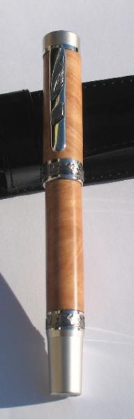

That's a good lookin pen.
Well, the BLO would be used in conjunction with the CA, so you're not out of the woods.
For the pics, use a stand and set the camera to macro. Also, set the timer to take the shot rather than your hand. Give those few changes a try.
thanks. Madrone Burl. First time I worked with it and it is nice all around from cutting to sanding - at least the piece I got.

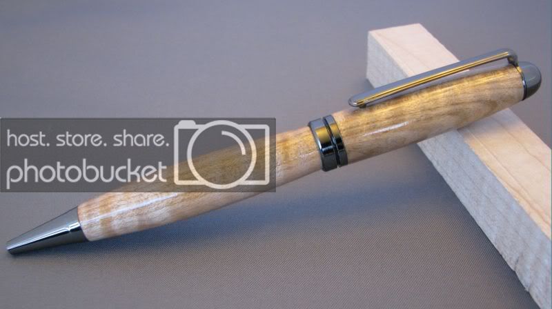

Ok I tried this after reading this post.I dyed the BLO black using Transtint dye about 40 drops of Transtint to 2 ounces (give or take) of BLO.Applied the BLO then the CA and here is how it worked.Kind of hard to tell from the photo but some of the BLO penetrated the softer parts of the Maple.It did'nt really come out as I expected,but it did seem to bring out the curl in the wood a little more than usual.Gonna give it another shot.I should have done one with just BLO for comparison but did'nt.
O....some of the BLO penetrated the softer parts of the Maple.I....
Yeah, I think if you want it to evenly coat it you'd have to tint the CA. Anyone want to risk a few bucks and drop some dye into the CA bottle? Just make sure it doesn't act as an accelerant.
