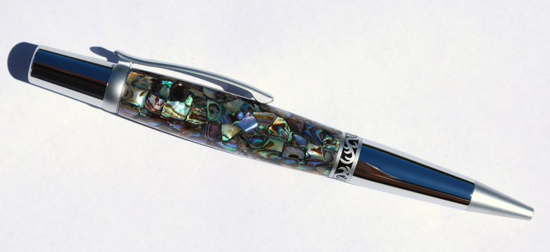

I finally had a chance to turn one of these blanks I made from the awesome gift of Abalone Shells I received from Toni. They are beautiful shells and I only wish my photos showed them better. Thank You again Toni! This one went to my sister in law. She loves the Ocean and all it has to offer.

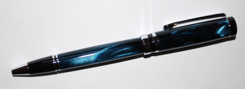

The second is a Madreperlato blue blank that I got as a freebie from Exoticblanks.com I had a request for the most beautiful blue I could get. It fit the bill and is much nicer in person when you can turn it and see the swirls come to life.

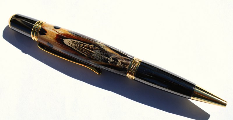

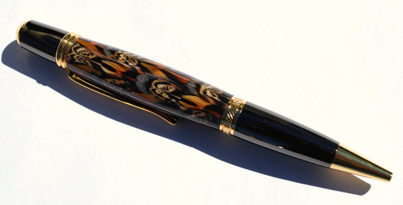

The last two are my kids. They picked these two blanks out of the last box full I sent to Dawn and Ed. They like to keep their teachers excited as to what pen they will have next.

Wow...great pens, but that Abalone pen is the sickest casting of Abalone ever !!! Did you make it from one of her big shells? It looks like it is cut up into a hundred or more pieces and expertly seamed back together, as opposed to the typical thin strips. Did you cast that? What the hell are you doing over there??? Where do you find all the time??? I am very impressed!

CAN I ASK HOW YOU DID THE BLANK?
LOL! I started with a bag of small shell pieces. Most of them are still too big to work so I broke them smaller when needed, but that was after I sorted out the flat usable ones. Then one by one with tweezers the shell pieces are glued to the painted tube trying to match and fill all the edges so the tube doesn't show. Sometimes I use a small nail file to shape the piece so it fits better. It takes an easy hour and a half to cover the tube. If I'm listening to tv it takes longer. Lol. Then they sit to degas for a couple days and then sand, buff and clean before casting. Most of my blanks are made between midnight and 3 am after I get home from work while the family sleeps.

John WOW the paua shell came out awesome!!! Let me know when you need more, looks like everyone is going to keep you busy. Let me know if you need more. Might have to find a new shop for them as the quake destroyed alot of stores.
thank you for showing the paua pen!!!
