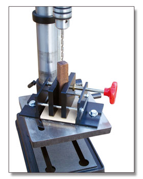

I think I may have found a decent self-centering vise.
Does anyone have experience with this vise?

Similar to the PSI model I have, but a few things that are different. I LOVE my PSI model, and for the money I am very glad I got it. If I even have issues with drilling its because I haven't lined things up right and never the vise.
It does not work as well as the PSI vise. The best one out there is Paul Huffman's vice, but I have been waiting for a year and he just announced that it will be awhile before he makes more.
I have that one - from Lee Valley.
<snip>
I had a lot of problems with the clamps racking on the LV vise until I used red Loctite on the connecting nuts and tightened very firmly. Not a Paul Huffman vise by any measure but works pretty well IME after the Loctite. I use the drill press and vise only for milling -- all my blank drilling is done on the lathe.

I can only tell you I've had my PH designs vise for going on 4 years, drilled probably a couple of thousand blanks without a mishap caused by the vise. Doubt any other vise could last that long and for sure wouldn't be nowhere that accurate.
You probably could drill thru a full size blank if you had a long enough bit. My bits are not long enough either so I still cut my blanks down to about a 1/2" over the tube size. That way I can final trim to size. I have not drilled any severely warped blanks but the chuck works on the same principle as a vise, grabbing two opposing corners. So I guess I don't see how a vise would be any different in drilling warped blanks.
