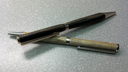

Hello. Just started turning pens, and heard some good things about IAP from some folks at the local Woodcraft store… so here I am to see if I can learn something, share in this fun hobby, and perhaps eventually contribute something. I've done basic wood working and some scroll saw stuff, but turning has a special appeal to me. So far I've only turned two pens that turned out pretty well. Thankfully no failed attempts yet. Both pens are slimlines (7mm); one oak with chrome hardware and the other macassar ebony with copper hardware. Going to give acrylic a try this evening. Try to post some photos – can't wait to try the great photo tips in the forum here.

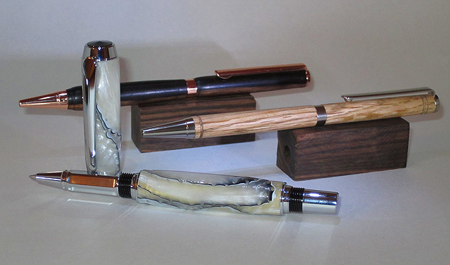

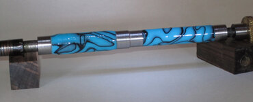

Need a little info, advice, direction, sympathy... This my second attempt at turning an acrylic pen; first one turned out ok (not great, but ok), but the second gave me fits. It did everything but turn smoothly and evenly. I could really use a little feedback on this... are acrylics just hard to turn sometimes (get a difficult blank), or did I just get a reminder that I've got a long ways to go on my learning curve? Any methods for smoothing it out after it is turned to size?

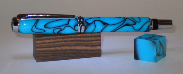

My issue with the acrylic turned out to be a teachable moment. A side from needing to do a few dozen more to keep from having this issue... was able to smooth out the blank very nicely. Started with 60 grit to take out all of the humps and bumps. Moved up through the papers: 150, 220, & 400. Then I switched to polishing componds; first 2 were automotive and last one was Ultra Shine plastic polish. Pen ended up turning out nice.
