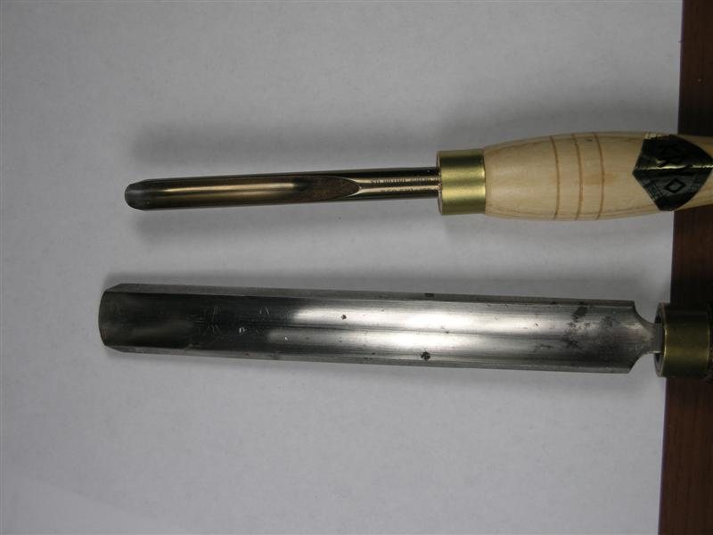

Without seeing the flutes from the end, I can't tell if it is a bowl or spindle gouge. My first impression was bowl. But, even that aside, I agree it is way too small for most work. I use relatively large gouges and skews for pens, 1".
Its designed for Pens whatever the grind.:) Ok so I am confused LOL with some many "I may be wrongs" LOL SO I am NOT suppose to use the tip on it to cut with ? Use the side ? Or am I using it upside down ? I normally start with the rest almost hitting as I break the edges but then as it gets trued I move it to closer but with the thicker gouge like I used to use you can get away with it not being RIGHT on it all the time. You cant with the little one.I have been turning awhile (18 yrs) but no formal instructions and mainly done pens. Does this help?

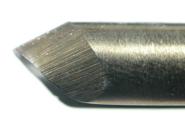

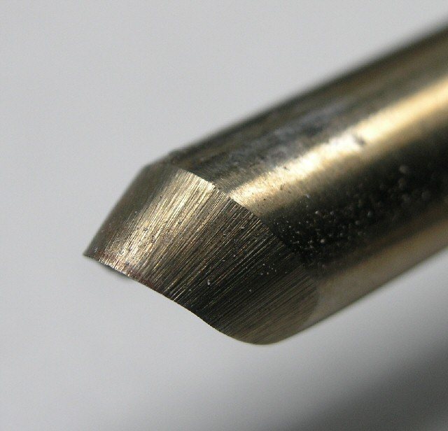

Well that sure is a fingernail grind, alright. The angle of that grind makes me think grabby, but hey ... I could be wrong! :P
It just looks really low to me - maybe I have been doin' it wrong all along! :P
I'd try to change that bevel angle to something closer to 60 degrees and maybe sweep the ears back a little further. But that's me. Everyone has their personal preference.
As to using the point vs. using the side. I may not have said it concisely - I use the tip, but i'm always slightly to the right or left, never straight on. And if the flutes are sideways a little (anywhere form 5-10 degrees to almost vertical) it tends to give me a little more control over the agressiveness. At least that's how it works for me.
With that shallow bevel angle, I'd have trouble rubbing the bevel without it being grabby I think.

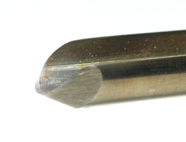

Suggestion: sharpen the tool. If the pictures reflect what you turned with - I am looking at a coarsely groud tool, not a sharp one. Sharp is VERY different from ground. This is the manufacturer's grind? Turning tools are not meant to be used straight out of the box...
I second a lot of what Beamer says. The angle on the nose seems quite acute leading to grabiness. An angle of about 40 degrees (depends on how each of us measure)could be tried. I think the shape of the grind looks good to me. I won't say you shouldn't cut with the tip, but I don't. If I am cutting to the right I am cutting just to the right of center. If cutting to the left I cut left of center. I believe this gives you more of a slicing cut, meaning smoother. You've been turning for 18 years. Do you have other spindle gouges you like?

I havent sharpened it. It was "thumbnail sticking" sharp out of the box.I also toy around with knifemaking so I know some about sharp [:D] I havent used a spindle gouge that I know of. I used the other one in the pic for last several years.I just figured if they were marketing these toys towards Us penmakers, they knew what angles and sizes worked best. OH btw , no offense was taken beamer.

The first thing I see in the grind is a drop in the edge right behind the tip. That's usually a no, no, makes it grabby. You want a nice curve from the tip to the end. Also it looks to me from the photo like it was ground on a course wheel. For small tools I like a 120 grit on a 1750rpm grinder or 100 grit on a 3400.

Looking at the pictures, I think it needs to be sharpened. The edge looks like it's just too rough.

Let me start off by saying that thing isn't sharpened properly. Tools are rough ground from teh factory. Many people are unaware of this and I'll admit that I wasn't for quite a while. It may feel sharp, but it has not been "honed". That being said, I think your technique might be the issue. If this tool is used straight at the piece like a scraper it has the tendancy to grab and and violently dig into the stock.

I tried it again and pretty much used that motion Fangar mentioned AFTER honing it some. I know that in the knife world there is 2 thoughts on sharpness. One is the polished edge VS the micro serations of the honed but not polished edge. I can see that the polished edge would be more on the line of what we would use.
