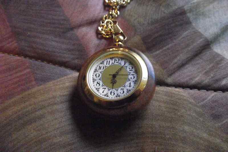

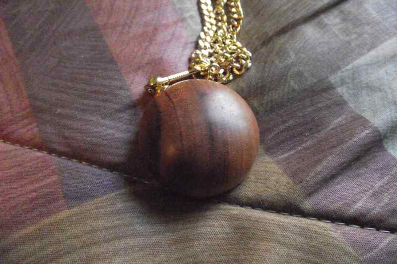

Thank you Paul... as a matter of fact that is exactly the problem: the piece just slips on the jaws without tightening. I'm doing what Grampy122 said: open the jaws so it requires a little effort for the hole to fit over the chuck. This seems to have worked so far. Here's my first. Bad photos... sorry.

Watch
Ulises, you did a really nice job on the watch. I know with that chuck it makes it easy to turn a watch or other small object. I can not remember where I bought them, but I have some replacement jaws that are a little larger. Have fun making watches.
