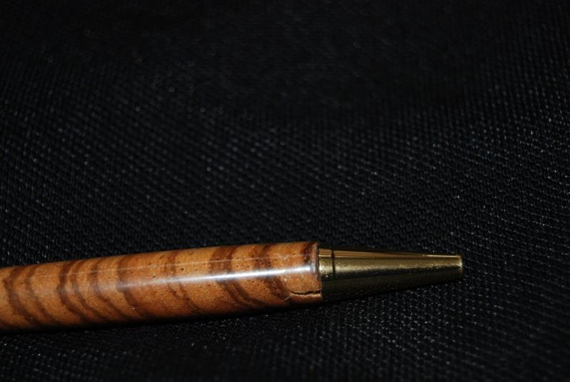

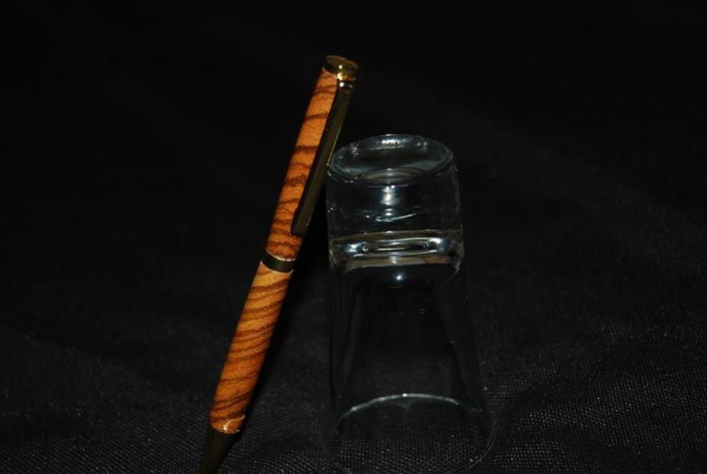

Brand new to penturning and working with a lathe! I turned my first pens today and thought I would share them with you all to get your critiques!
The first one is a zebrawood pen. The first project of any sort (outside of a few practice runs) I have ever turned. Overall, I thought it turned out OK - it could have been better. But, then as I was putting the bottom part of the pen it, using a hand clamp to tighten, it went in crooked and cracked the side of the wood! :mad: I guess I should spring for a pen press or wooden vice as I have read people do here. Any other suggestions?

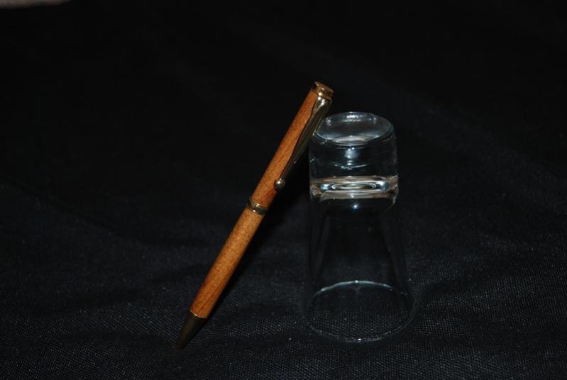

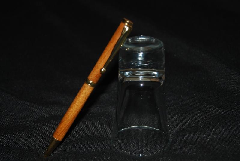

The second one was a Afromosia pen. All in all, I have no complaints on this one. The seams are smooth and it looks nice overall. I used a CA/BLO finish. What could I do to improve? Can anyone tell any obvious flaws through my very poor pictures?

Welcome aboard. Those are very nice pens for a first go at it. Put 'em in a drawer and look at 'em again in about a year. Your progress will amaze you.
You might try using your drill press (assuming you have one) to press your pens together until you can get a pen press.
Turn 2 plugs with a taper to suit both your headstock and tailstock. Using the travel on the quill in the headstock, you can press the components together.
Nice pens, too bad about the Zebra wood, Cross Cut Zebra is very pretty, also very temperamental, like Keith said you can use your lathe as a press also, but a 1/2 ton or 1 ton Arbor press is great.
I used my drill press with a wooden insert in the chuck and a piece of plexi on the tabletop. I HIGHLY suggest you get yourself a real press. For me, It made such an incredible difference, My only regret is that i didn't get one sooner.

Just a suggestion and get rid of the black background and use either a white or a grey background and the pens will show up better. To pull off the black background you need better lighting and right now you don't have it. Just a suggestion.:smile:
Just another suggestion. I would work on one style pen until you are comfortable with handling the tools and the general scheme. My reason for this suggestion is that if you concentrate on only one style you will get a lot of practice and learn to see the things that need improvement. I found in the beginning that if I did too many styles I couldn't really see the differences in my skill level, since there were so many differences in each pen. I worked with slim lines, which are actually a good pen to learn on since they give you so many opportunities for variety. To make an excellent slimllne takes a lot of skill.
Great first effort. +1 on putting them away as representations of your first work. I wish I had done that when I first started. Practice and don't be afraid to try new techniques as you settle into your own method. Welcome from Texas.
Wayne
