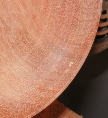

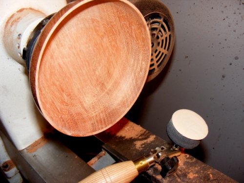

My problem is (very) basic sanding technique. I can't seem to get the insides of the bowl smooth and without sanding lines. This has been a problem on each of the half dozen or so bowls I've attempted, Case in point is this one currently on the lathe. It's Brazilian Cherry, about 6 inches in diameter and turned to about 1/8" thick. I'm using the Sorby sanding thingy as shown. Sanding the outside of the bowl goes very well, with out any problems. After shear scraping, the inside looks good, with the exception of some stubborn end grain, which I'm pretty sure is due to vibration and I think I know how to fix that. But as soon as I start sanding I have 'permanent' sanding lines that just don't seem to go away. Any pointers to FAQ's, tip files other sites, etc. would be most appreciated.

also the line by the rim looks like tear out not sanding scratches, you have to do a lot of sanding to get rid of that.
This has happened on a number of different types of wood, maple, eucalyptus, east indian rosewood and red morrel burl in addition to the brazilian cherry shown. After shear scraping, I start with 180 grit, which seems to me about right given the quality of the surface after scraping. From there I go to 220, 320, and 400. But the problem starts right at the beginning with the first grit, whatever it is. I just can't get rid of the sanding lines.
And yes that is tear-out near the rim. Like I said, I believe that with the fairly thin wood, I'm not sufficiently controlling vibration to let the scraper get it, but I think I know how to fix that.

Turning at 1500 rpm, sanding at 600 rpm. I thought it might have been an edge of the sander or a crease on the paper or something like that. Tried different angles on the sander, tried hand sanding, kept a close eye out for edges, but I don't think that's the problem. I saw a new foam rubber 'mesh' thing a Lowes last weekend, I might give that a try, since it has no edges and is much more flexible than the normal foam sanding sponges.

600 RPM seems a reasonable speed.

I know many people like the inertia sanders but I am not one of them. Yes I do own one and have used it several times. For the inside I have one of the velcro heads that I put into a cordless drill and it seems to work better for me.

The problem shown in this picture is (it would at about 4 o'clock near the rim)
you are getting tear out. It could be tool control or just ornery wood.
Lets assume it's ornery wood, try wet sanding with your 100 grit gouge. (If it was worse I would say use your 60 grit gouge). Most people use what ever finish they plan on using to wet sand. For me, I use some home brew danish oil.

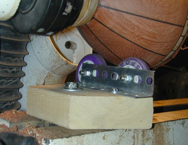

It might be that the bowl is flexing while you are turning. This happens with thin bowls. You may need a steady, although this problem is usally found with deeper and/or larger bowls
The sanding rings may be because you are holding the paper in one place to long, although that doesn't usually happen with the rotary sander you are using.
Stopping the lathe between each grit and sand with the grain will help remove those sanding rings.
Lastly, try sanding by hand, just to see what happens.

What you have there Dave are Tool Marks.
Your cutting edge is skipping across the wood in that area (transition area).
The only thing to do is start your sanding process over and get the whole area down to the same level as the lines, which are deeper and show up real good next to the shiny sanded wood around it.
The transition area from side wall to bottom is almost always the hardest area to cut smooth even with support, slow speed and Sharp tools. Perhaps on the next one, and you know there will be a next one, try a little putting a lite coat of finish on then performing your Finsihing cuts. This will help you see areas that need attention and smooth your cut. Very lite pressure and swing tool completly from lip to center or vice versa.
