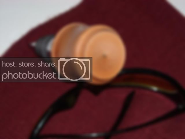

Closeup....

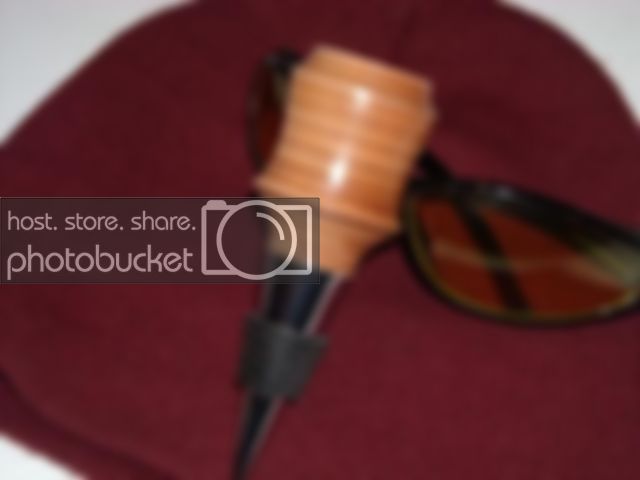

Top...
There are 11 pieces of 1/4" raw leather bound by thin CA and pressed in a bench vice for about an hour sometimes less. Just for the heck of it. Sanded with 100, 320, 400, 600 and a HUT friction polish. I wanted it too look natural still. And over time with use will gain some character from oil from the hands.
