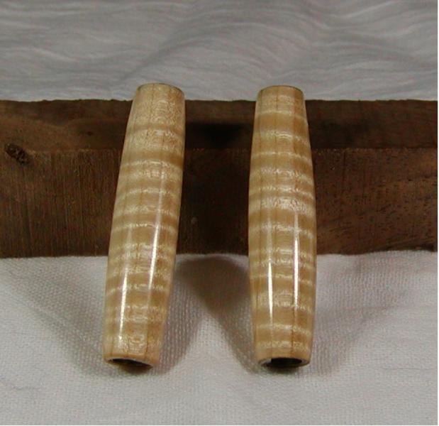

Apples to Apples compare.
I decided to do a little experiment and did two tubes in maple.
One was my old ca technique (BLO, 1 coat thin, 7 coats med, sand through all the grits, hit it with huts polish)
The second was the new system, but with extra sanding (BLO, 1 coat thin, 5 coats med, 400, 600 & the first two pads of micromesh (wet), then the polishes).
I think that the extra sanding made all the difference (unless it was the fact that it was 75 degrees instead of 60), the straight CA might be *slightly* better, but that might just be the extra two coats and I don't see any scratching like there was before.
The one on the right is CA, the left the new stickfast system

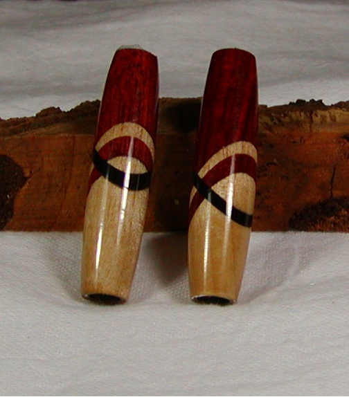

Apples to Apples take 2
Ok, tonight I used Penman's technique. No BLO tonight because I don't want to turn the bloodwood orange.
Left: Usual CA technique (left a ca tag on the end) - Sand to 600, 1 coat thin, 7 coats medium, dry sand 320, 400, 600. Micromesh wet through the grits, finish with a coat of huts polish.
Right: New Stickfast: Sand to 600. 2 coats thin, 5 coats medium. Dry sand 400, 600, mm1500, mm1800, satin polish, gloss polish.
I think that the stickfast system wins tonight, you can see a couple of places on the CA where the deep ridges weren't quite sanded out. The new system goes on much more smoothly and I don't worry that I'm going to sand through trying to get the ridges out.
