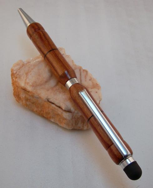

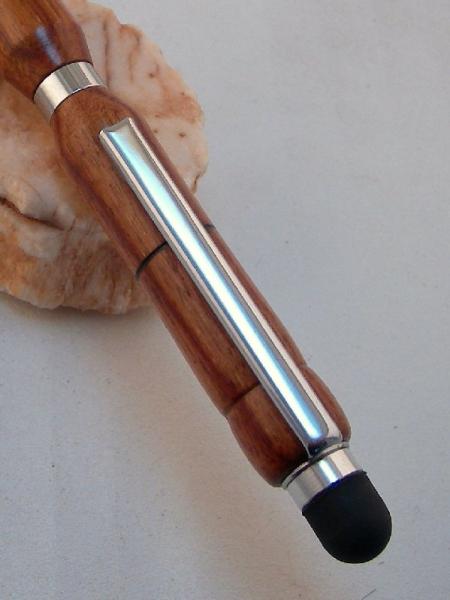

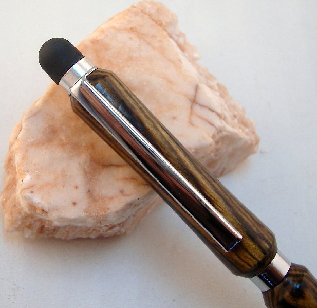

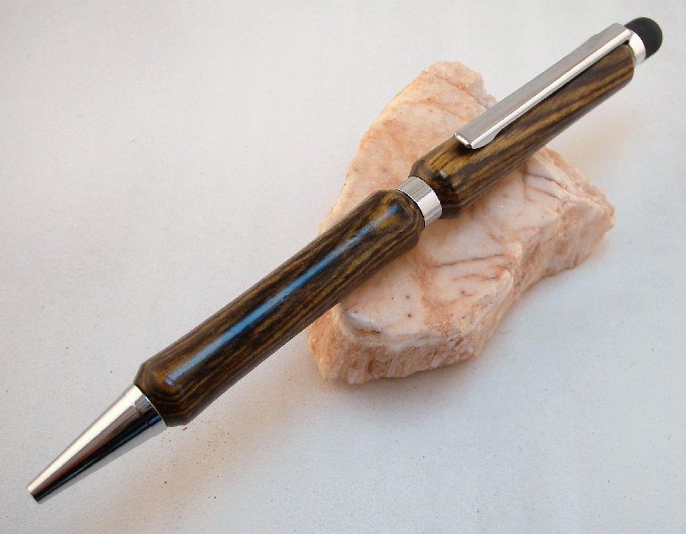

I tried out the new soft stylus kits recently made available. I wanted to try them out on a simple 7mm pen kit, so I turned a couple of slimlines. The stylus kits install easily, and work very well on the new tablets, IPads, and smartphones. The first pen is tulipwood, and the second one is wenge wood. Hopefully, in the future, the manufacturers will come out with other plating colors instead of just chrome, and maybe other sizes than just 7mm.

Very cool. I've been curious about the new capacitive (sp?) kit from CSUSA. I like your idea of coupling it with a pen.
i also got in some tips too. if you hold the stylus without touching metal on your pen does the stylus work?
i have a wood only stylus with a 7mm hole which i inserted the tip and it doesnt work ;(
nice looking pen by the way
Seamus, I will definitely let you know how they go. To be honest, I was in a hurry to post these pens to the group, so my woodwork is not really up to sales standards, but I am going to do better. Right now, these 2 pens were put together for testing. The thing I like is that these add-ons can be offered as an option, including the Cross style hard stylus in place of the ink cartridge. In that case, a person would have a stylus for any kind of device.
Craig, when I tried this out on my wife's Samsung tablet, it worked perfectly just by gliding it across the screen. You don't have to really touch the screen or only lightly to activate a movement; not like the old PDA style hard styluses.
If you make them without the center band you can make them any size. I buy stylus from a company and then dismantle them and use the parts. You can use a 7mm tube. clip and finial. I have lots of extra parts and just use them.

I have checked into this and here are my findings. The brass tube is necessary to act as a conductor to your hand. With the brass tube inserted you can make sufficient conductivity without touching any metal hardware. There is however a limit on how thick the blank can be between the brass tube and your hand. If this limit is passed then conductivity can still be made by having your hand be in contact with a center band or clip. Please let me know if there is any need for clarification.

The iPad, iPod and such are heat sensitive. The reason you need to be aware of the thickness of the material between tube and hand, the reason it is best if you can touch metal connected to the tube that the new stylus tip is connected to . . . is because it needs to have heat conducted to the soft stylus tip.
I think your idea of having it on as pen cap for SL is brilliant. I love the Wenge stylus pen - beautiful finish, too!
I can vouch for that. I made one with a piece of dyed BEB, but did not drill all the way through, and cut a slimline tube in half (about 1" each) and glued one in each end. The stylus does not work unless my finger is touching the metal band around the foam. Be careful out there!
