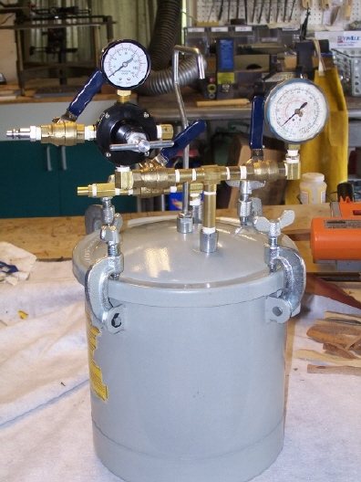

Well I sure enough took advantage of the pvp tutorial. I made my order from HF and then ran to the Local Lowes and got the fittings. My only problem is that the Vacuum pump was on back order from HF. So.... I bought on on e-bay, believe it or not it was 30 cents cheaper ( with shipping and all) I am still waiting for it to get in.
The only thing I could not understand or was not mentioned in the tutorial was, ....when you take out the vacuum block from the pump,and attach the block to the pot, what causes the vacuum? I am new at this and would like some help as I think I am missing something.
I also attached a pic of my set up. He was right when he said the HF fittings are cheap and extremely hard to remove!!
I saw in the previous post that someone had a actual vacuum pump attached to the pot.
What would be the best avenue? Take the HF pump apart and use the block or use an actual pump like in the previous post?
Please help!

Thanks for the insight, But the HF block that connects to the pot as a Air Compressor male attachment. I guess I dont understand how adding air to the pot will take it out of the pot with the block?

A good vacuum pump is always going to be better (and easier). Using a venturi pump, you will need to have a compressor with a pretty big tank to achieve a really good amount of vacuum. On the other hand, those venturi pumps are much less pricey.

Guys you can trust me, it only has the parts that Stvers suggested, as my wallet felt each one of them when I went to the checkout counter......It was worth it though. It appears that I also have a leak somewhere. I am fixing to do a leak test on it.

Wow Joe, I am flattered. You did almost an exact reproduction of mine. If you still need help in the vacuum dept, let me know. You are welcome to E-mail me if you need.
The easiest way to find the leek is with soapy water. At first it will seem as tho it's not working, but as soon as you find a leek, the bubbles are unmistakable.

It may be a moot point now, but here is a link to a less-complicated setup. http://www.blindsquirrel.us/Scott/PressurePot.jpg
Detailed pics: http://www.blindsquirrel.us/Scott/PressurePot/
To seal my threaded fittings I pulled a vacuum on my pot and applied thin CA on all of them.

Well I did the leak test and found two leaks. One was from the HF rubber gasket on the base of the lid (inside). The rubber gasket was just junk. I took a rubber washer from a brand new water hose and ....problem solved. The second leak was on the HF regulator on the base. Though the leak is small It still made me mad. After several test of taking the regulator off and using it on other items, it was determined that it was not my plumbing job with the Cheap regulator. I contacted HF and they are sending me a new one. The one thing that saves me on this leak is the second ball valve on the other side of the regulator. I can now get my pressure and cut the second ball valve off and not have to deal with the leak.
