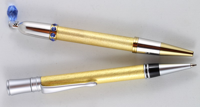

Picture of No Press assembled "pens"
I decided to include a picture to complete the report.
The picture turned out OK, but I don't enjoy doing pictures because my camera (Canon T5i with 100mm macro) does not have bluetooth capability so it is a bit of a pain to have to connect it to the computer with a cable. . And then I don't enjoy editing pictures on the computer either.
Anyway, here is the picture of two No Press pens I got today from PSI, a Diva Charm with blue crystals, and an Executive with Satin finish.
