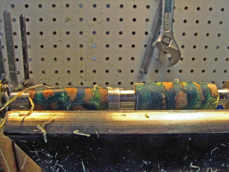

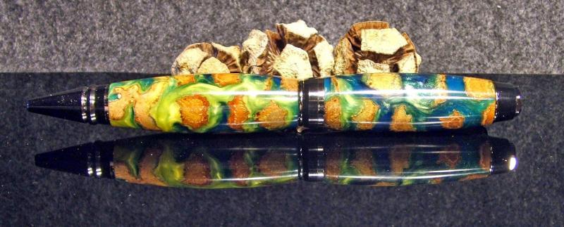

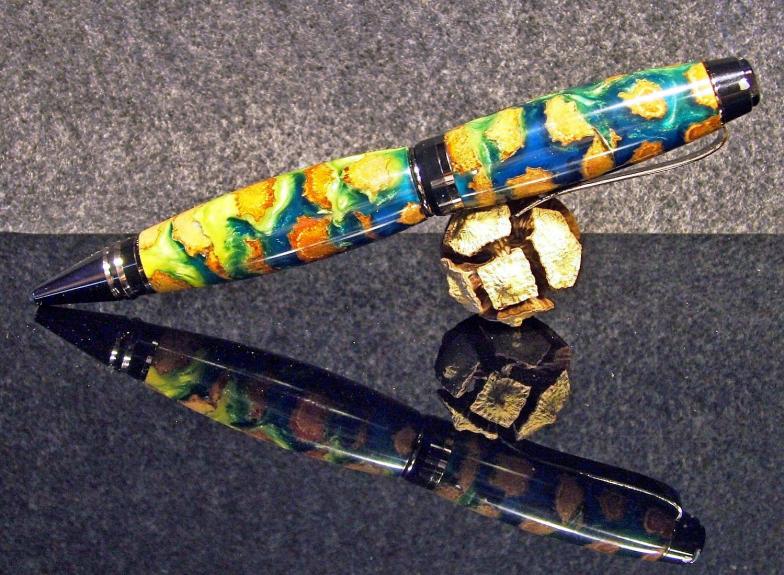

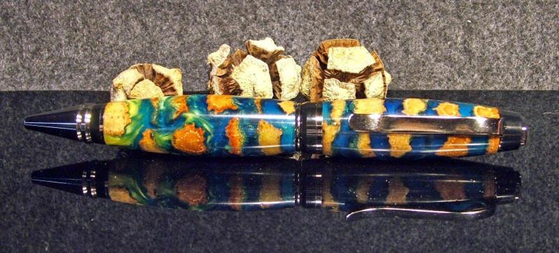

I have been kicking these pine cones around for the last twenty years where I work. They fall out of the trees that line the sidewalk, and are all over the sidewalk. And since they are round, one good hard kick and they will roll for a long ways. Well I stopped kicking and started picking them up. I put a few of them into a 1" PVC pipe and mixed up some green, and yellow with pearl Alumilite and poured it in to the tube then put it in the pressure pot. It has a CA/ BLO Finish and has been MM to 12000. Tubes have been painted white and is on a black Ti Cigar. This one was sold as soon as I told one of my co workers what I was going to do with the cones.
Any comments or suggestions welcome, Thanks for looking! :biggrin:

Well my friend, you've gone and done it again. Beautiful pen. It will catch someones eye real quick, but wait, you have already sold it!!!
That is really one beauty of a pen! You know that all the colors remind me of? Some underwater wonder. You did a wonder with that cone!
REALLY COOL PEN! man i gotta try this pinecone business. cool stuff indeed! I just wonder if it would work with PR.
