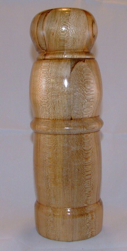

These are my latest pepper mills and attempts at getting decent photographs. Just got a new light tent and trying it out tonight... Need any help you guys can offer on using the lights and tent. As I said in Pen Photography, I am really camera challenged.

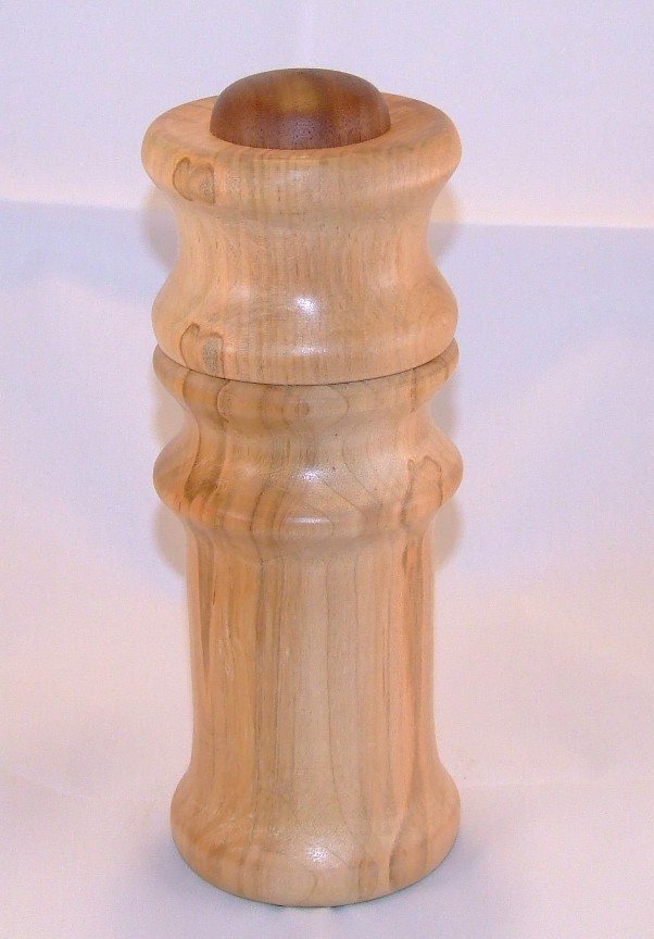

First is Ambrosia Maple with a Walnut cabochon... this was originally a standard pepper mill with the little knob on top, but it didn't quite fit like I wanted it to, so re-drilled and turned it into a crush-grind style. Finish is Min-Wax.

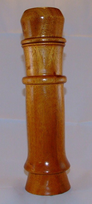

The second is another Ambrosia Maple crush/grind that was ordered as a welcome home gift for her soldier son. Finish on this is Watco Butcher Block Oil.
Final one is from a block of Mahogany.. also a crush grind style. Also finished with Watco.
Comments and Critiques welcomed...

Chuck: Those look very nice; but let me suggest an alternate design for you to think about. Your mills (or at least the ones pictured) are pretty much straight up and down designs with a few coves and beads. Many of the mills I have seen have a different basic shape. They are a little slimmer in the waist and a little fatter at the top and bottom.....a subtle "hourglass" shape. I think this "hourglass" shape has a more elegant and sleek look to it. You can keep the beads and coves if you like; but try one with a narrower waist and see what you think.
Here is a picture from the CSUSA catalog of the basic idea. This one is a very basic modern look.
And this one has some decorative work done in the more traditional style.

Very nice, Chuck! Randy has a point though and I think a combination of styles, both narrow waisted and columnar, would probably appeal to the widest customer base. I haven't done any of these, but since I do love freshly ground pepper.... That Watco Oil sure does shine! Is that after a lot of buffing or just hand rubbed?[:)]

Lots of questions. First, I tried the "crush" mech from Woodcraft and I thought it was difficult to make and would not do a very good job. Was there something I missed??? I know you know how to make peppermills, do you LIKE this mech??? OR is it just something different to offer?
I also would like to know about that Watco Oil. The finish is BEAUTIFUL!! (Still wet????[}:)][}:)]) Seriously, how many coats, is there a sanding sealer? How did you get it so shiny??? Are you comfortable that it will stand up to kitchen use???
As for design, every peppermill I have ever made has sold. Some are plain, some more intricate. Different buyers for different styles. If you are "craft-showing", display lots of choices and expect about one a day to sell (displaying about a dozen). Price point starting at about $50.

Actually, I was looking for critique on my photography work.. I just got a new light tent and am trying to work out how it works... as I said, I'm kinda picture challenged when it comes to a camera.
Ed, to answer your questions, I like the "crush/grind" mechanism because it's much more forgiving on dimensions... I'm also a little measurement challenged on the standard mills... other than having 3 or 4 different drill bits you have to work with, I think they are fairly easy to use... the shaftless version is a little trickier.. it generally takes 3 parts and getting them all to fit is tough.
I buy my kits from Packard.. they're a little better price.
I bought the Watco Butcher Block oil at Lowe's. It's actually like a sanding sealer or lacquer finish. This one has three coats on it... first one has to dry about 6 hours.. then the second and third has to dry for 72 hours. The shine rose with the second coat and really came up with the last coat. No buffing required.
I can only hope it will stand up to kitchen use..
The ambrosia maple is actually an order... the lady saw one I had in cedar at the local bakery and wanted one of same design, but in the maple..
I have a few more in the shop to do and think I'll take some of Randy's advice and try some wasp waisted one.
