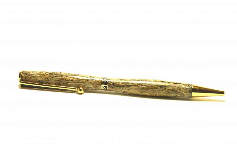

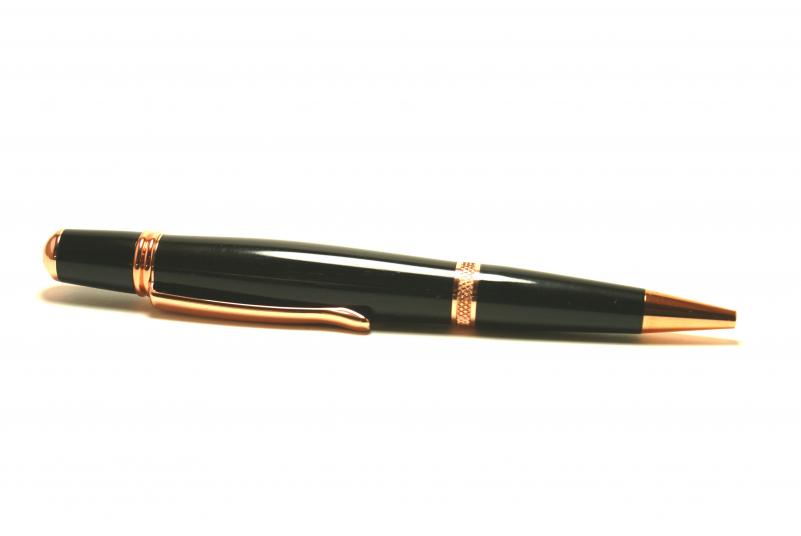

I'm a pen turning "newbie" and below are pens #22 and #23 for me...
Pen #22 is turned out of Ebony .
Pen #23 is turned out of Crushed Sun Flower Seeds .

Are you casting the sunflower seed blanks, or ??

Thanks everybody for the kind comments. I've been tackling wood, acrylics, and segmented wood ... and compressed materials like sun flower seeds.
I bought the sunflower seed blank out of a clearance bin at my local Rockler wood store. I turned a little, and then used thin CA on the ends to prevent splitting. After more turning, I used thin CA again on the entire blank and let it soak in to hold it all together. After first rough sanding, I CA'd again to ensure gaps were filled.
All my wood finishes are using Doctor Woodshop Walnut Oil / Carnauba Wax / Shellac friction finish ....3 coats . The Ebony wood was also Doctor Woodshop Walnut Oil / Carnauba Wax / Shellac friction finish.

Is that true Ebony? Your finish is absolutely beautiful. It is the way Ebony should look. I have been trying to make Ebony pens that look as good and don't split. You may have found the secret.
Is it true Ebony? I don't know...but I bought it at my local Rockler wood shop...it said Ebony ...maybe it's beginners luck !
I have read many posts about Ebony splitting, so I was careful not to heat up the blank, except during the friction polish....but still kept the heat down.
It was really slow drilling...took my time allowing the bit to cool. The round carbide tipped wood chuck pen pro had no problems and made quick work.
