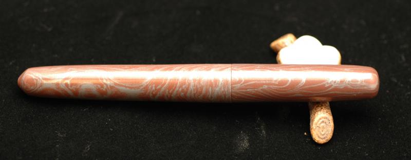

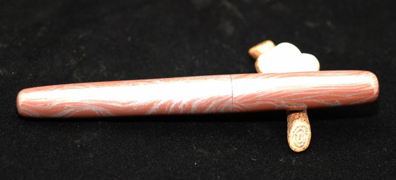

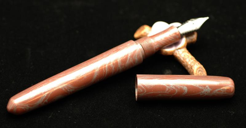

Hi All,
Here is my new design pen I call "The Patriot" because it is Kit and Clip Free, the Size is .620 and is 5" 5/8 Capped, 5" 1/2 uncapped , the pen weigh is 50 Grams, the blank is made for M3 Metal Composite, this was my first time using this material and it turned very nicely.
All comments are welcome.
Nice job on that!! The only suggestion I can offer is that you could have made both ends rounded. As it is the bottom of the pen looks more pointed then the top of the cap. I personally like the rounded top of the cap. I have 8 pieces of M3, just been waiting for the courage to try something with it. I hope what ever I do comes out as nice as yours.
Tim, I love this pen. It looks very Nakaya-ish. Simple, classy,..elegant. I too, would rather have the body end match the cap end profile but damn fine as is. Definitely envious of the thread work.:mad::wink:

wow, great job!! I too am interested in learning the whole threading thing, is that a special tap and die set to get the triple thread? and if so, how much?
Hi Seamus,
I cut all of the threads on my Metal Lathe, I do have a custom made Tap and Die that cost around 400.00 for the set, I only use the Tap or Die if I need to clean up the threads a bit.
