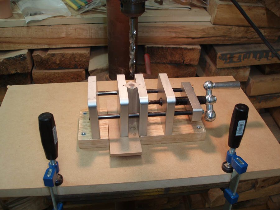

Here are some images of my drilling set up. The vice is screwed to a 3/4 inch sheet of MDF and that is shimmed and clamped to the drill press table. I line up the center of the vice to the drill bit by dropping the bit and clamping the vice to the bit.

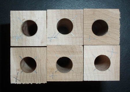

Here are the tops of the blanks all centered.

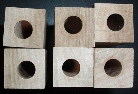

Here are the resultant bottoms. The one in the lower right is the best.
Have you tried putting that vise flat on the drill press bed without the 3/4 inch board and all those clamps and shims?
Also, I would make sure the two black horizontal shafts are very tight. If you open the vise, the shafts protrude so that you can get a wrench on the flats, refering to the ends away from the handle.

Hi Boz. Welcome to the Forum! I can see from your photos that the bottom holes are not in the center of the blank, but it appears that they are close enough that you should be able to turn these blanks on your lathe with no problem. You have plenty of remaining wood on all sides of the hole so forget about trying to make perfect holes on the drill press and just start turning. I learned a while back that "Sometimes the enemy of good is better." You should be able to make great looking pens with the set up you have.
rclotsch is the voice of reason. I, also, felt all your holes were more than good enough for normal pen turning. You only need precision if you do fancy work like celtic knots, etc, that need perfect symetry. If you need that, don't use your pen vise and switch to a machinist vice like you mentioned in your original post. The pen vise is more for convenience and speed than it is for precision. In your before and after pictures, the before shots showed a couple of holes as off center as your after. Unless you take a dial caliper (or similar) and measure each blank... distance from each side to the hole... comparing the top to the bottom, it is hard to tell if you are consistently drilling at a slight angle. If your machinest vice produces accurate holes, then your drill press must be Okay. I hope I don't sound critical. I don't mean any criticism. Enjoy some pen turning. You may find this all works out. :)

Welcome from NC. Have you tried with a different drill bit? Having said that, the blanks in your pics are fine for the type of pens you're making. But keep searching and this crowd will help you get to the bottom of the problem.

As already said, the blanks you've shown are fine for turning based on the kit you mentioned. As you do more, you'll learn what you can "get away with" and what you can't.
