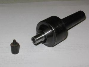

I've made two different versions of mandrel saver adapters,
one for the Oneway style live centers
http://www.woodturnerscatalog.com/s...y_Revolving_Center___1way_revolv_center?Args=
that threads onto the nose in lieu of the stock attachments
and one for the Pro Live Center Set
http://www.woodcraft.com/Catalog/Pr...=1576&ss=7cb1c9a7-faae-4f4b-bec1-dd4f4acae9ea
That is used in lieu of the standard inserts
The version for the Pro Live Center Set is a lot easier to make of course, but I haven't had it long enough to form a good opinion yet.
For most stuff at home, I tend to turn between centers, but for turning at shows I will most likely want to use the mandrel saver adapters for safety reasons.
