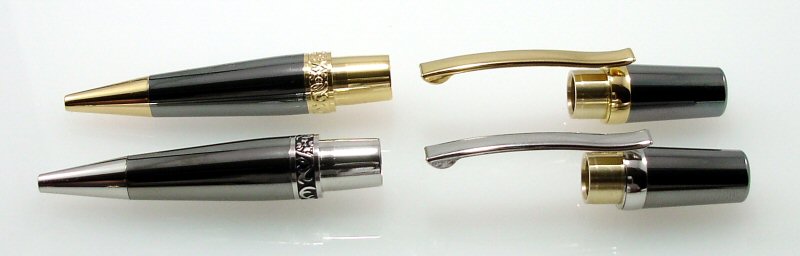

Photo of new Berea Elegant Beauty kits
I just received my order today from Berea. These kits look super.
There is a nice deep relief on the centerband - makes it look "elegant".
These will be a nice addition to the Sierra-style kits that are available that use the 2.25" tubes.
Bruce, your pictures look great. Would you say that the colour of the gold pen is accurate in your picture? The picture on the Berea Hardwoods site is sort of orange looking.
Bryce,
I double-checked the Berea photos-the Black Ti on the actual kits is darker than their photo. And the actual gold is a deeper orange than on both the Berea photo, and the one I took.
I just started the pen photos, and admittedly have work to do on color accuracy.
I recommend getting a sample of each from Berea while they are on sale. You won't be disappointed.

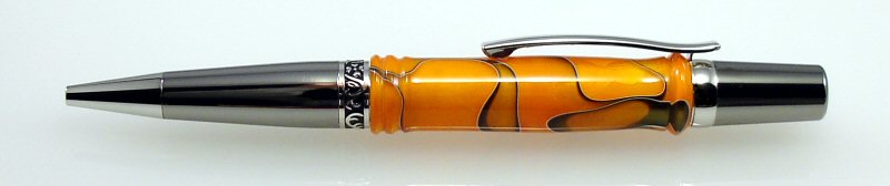

Sample of Berea Elegant Beauty Black-Ti/Platinum kit
I took the other half of the TieDie blank that made it to "Featured Photo" today (couldn't believe that when I saw it!) and made another pen out of it this afternoon to use with a Berea Elegant Beauty kit so you could see it dressed up.
The Black-Ti color in the photo is really close to the actual piece. You can see the centerband relief is deep, and it shows off well in hand.
I would think that these would be very appealing to customers - the plating in both the platinum version and the Ti-Gold are the specs that should be most durable, and, they look great.
This was my first try with "Ed Davidson knurls" as I didn't want the blank thickness at the bushings to get too thin and start showing the white brass tube through the semi-translucent blank. All with a 5/8" Lacer skew!
