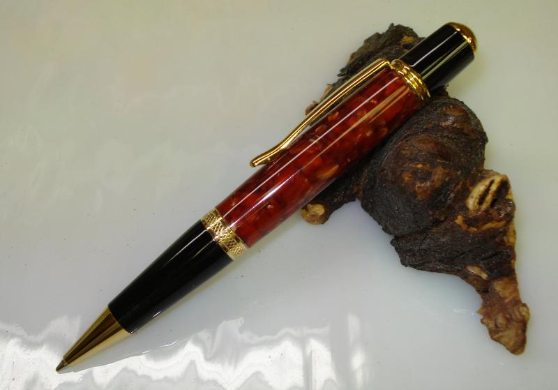

Yep, classic looks good. Did you paint the tubes or the inside of the hole? From my experience with that blank it really needs it.
Maybe I'm missing something.... No I didn't paint the tubes, but you can see them... maybe it is the photo... Well... looking again.. maybe I should have..

You left your photo up for 36 minutes, and took it down after one post of constructive criticism?
Unless I have missed something, you need to grow some thicker skin. We learn from critiques.
Pleas repost the photo. If it is a "mistake", we REALLY need to see it, so we all can learn from it. Seeing a photo pulled because of some constructive criticism also causes people to hold back comments that could actually help posters grow.

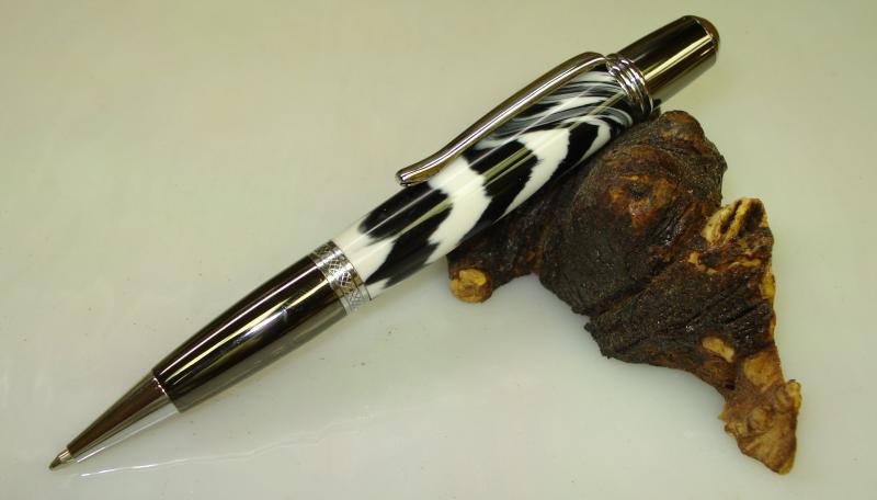

here it is

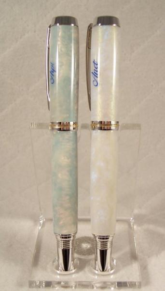

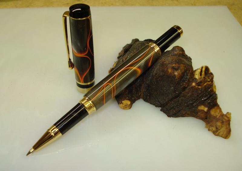

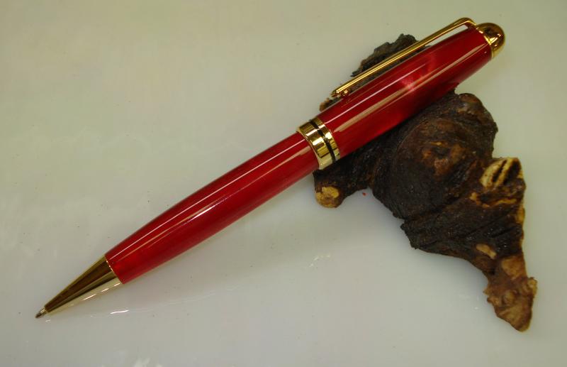

i'll add a few more.. Pictures aren't the best
Don't take this as a critism either but when posting photos it is nice to tell us the kit and maybe the blank used. What are the red blanks in the 3 photos you posted last. ???

Thank you for reposting your pens. My favorite is the Euro in red acrylic.
As to your first pen, I believe it is the Acrylic Acetate AA-03 blank, available at Beartoothwoods.
I just did a number of Acrylic Acetate pens using El Grande kits. When thin, most if not all of these blanks benefit from painting the tube and the drill hole in the blank. Using black for this would have given you a result more like what you have when the blank is first rounded. I would suggest that you consider using a paint close to the dominant color in the blank for best results in this family of blanks.

Brian, Don't take offense if you already know this as others might not know either. To illustrate what William is talking about I attached a photo of two pens I did last year. They are both from the identical blank. One was glued over a brass tube while the other was glued mixing some white pearl PearlEx powder with the epoxy. Big difference huh!
Personally, I don't paint tubes, I tint my epoxy instead as I think it makes for some more spectacular pens. After a while you'll get the hang of which blanks are translucent and which need their tubes painted or your glue tinted.
