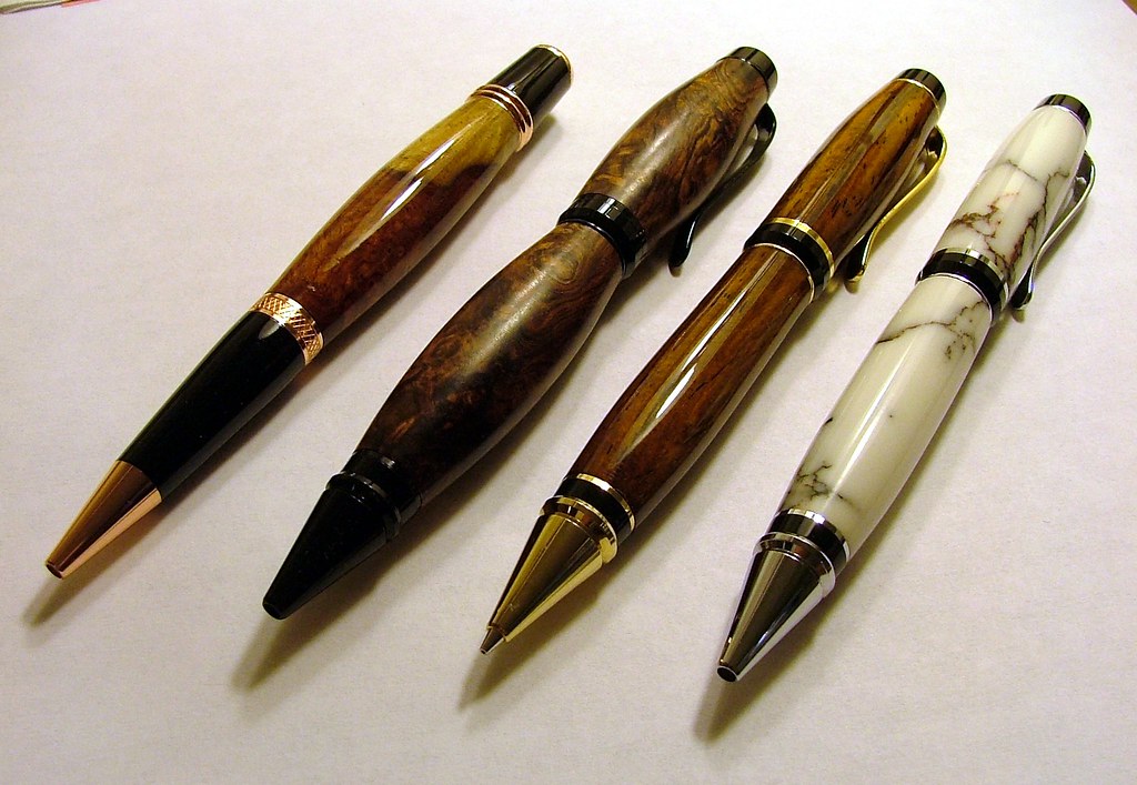

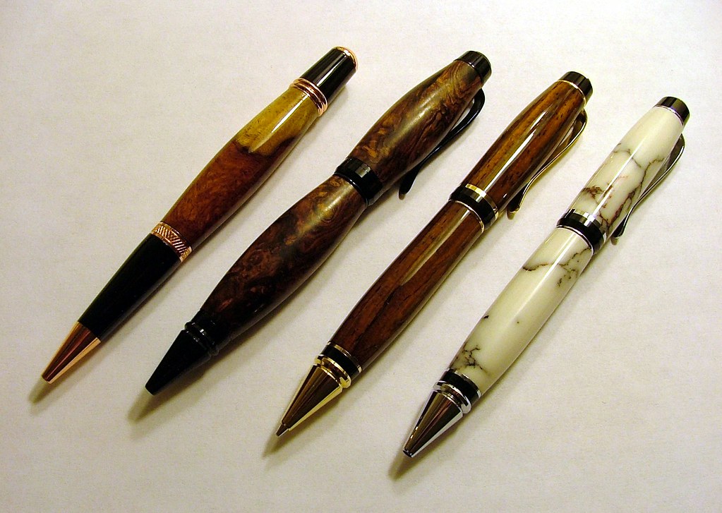

Hello all. I got into this pen turning in the Fall when my girlfriend and her family got me a starter package from PSI. She knew pen turning was something I wanted to try, but being in college, I could not afford to take up. Since then, I've made about 15 pens. I think 6 or 7 were gifts. Here are four that I have and (despite the talent I've seen here) like a lot.
From left to right they are:
Amboyna Burl Wall Street II
Honduras Rosewood Burl Cigar
Cocobolo Cigar Pencil
Wild Horse Jasper Tru-Stone Cigar
On the Tru-Stone, it cracked when I was assembling. Once I get back home from school (where my lathe is) I plan to make some sanding dust from the Tru-Stone scrap and use that with some CA to fill the crack. Should that work ok?
I've never used trustone but I think your idea for a repair method will work OK. You may need to disassemble the pen and then perform the repair, throw it back on the lathe and refinish it. Just a note about cracks while assembling - make sure the tubes have no residue from whatever you used to glue the blank on (epoxy, CA, etc). Also I've noticed that some kits have a little too much plating on the parts that get pressed into the tubes and scraping it off sometimes helps a part that seems to be too tight.
Thanks for the compliments everyone!
Schtick, the pencil is from Woodcraft. I think it's pretty cool because it actually has a twist-click mechanism. Being an engineering student, I "needed" to find a nice pencil kit that I could use daily in school.
Arjudy, I'll try removing any and all residue that gets in the tubes next time. I like the way the Tru-Stone turned out otherwise!
Jimofsanton, the poorhouse is right! I'm not sure why, but most of my hobbies require a bit of money!

Thanks! I like the shape of the last two the most, too. The honduras rosewood burl and black cigar is due to get disassembled, turned down a bit, and refinished with CA. At the time, I liked the more round shapes, but have since gotten over that. It will probably remain a little bulby, but not like it is now. Oh, and the cracks are on the lower barrel. Oh well with those. I'll do my best to fix them and give it another try with some different Tru-stone. Darn! :biggrin:

Those all look nicely done. Good selection of materials and it looks like great fit and finish. I'm not a fan of the (particularly large) shape of the Rosewood burl cigar, but I that's just personal preference and there's certainly nothing wrong with it.

I plan to disassemble the Rosewood burl cigar, trim it down a bit, and refinish it with CA. It's finished with Hut PPP bars, which don't seem to make it very shiny.
