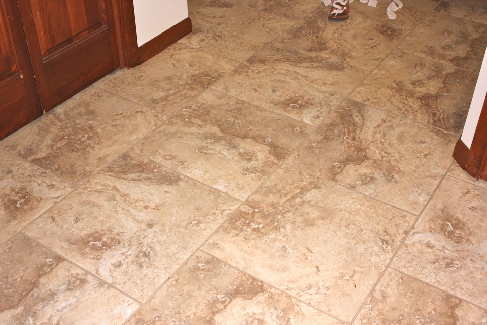

Just had 3 bathrooms done - I DID NOT DO - This was what the contractors did ( house built in 1964).

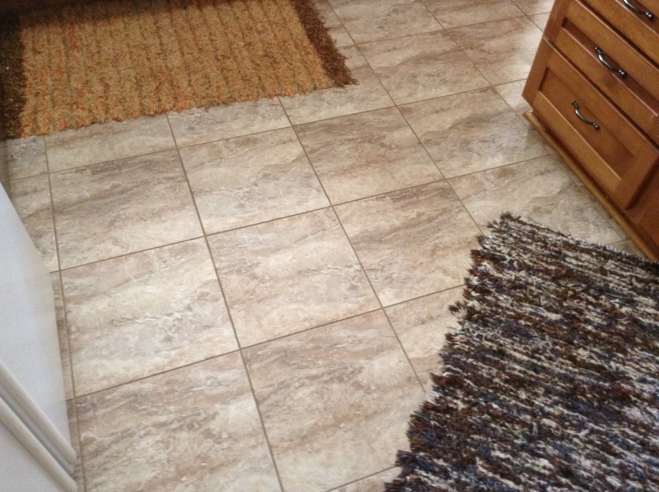

Just to add more thought to consider, i had my kitchen and master bath done with a product called congoleum. I have never had a tile looking floor i was more happy with! Its like a combo between linoleum and ceramic. When people come in they swear it must be ceramic tile. But it is not cold on the feet, it allows for movement, you drop stuff on it it doesnt dent or break. It cleans even easier than tile and it is grouted, but the grout which looks like real grout is kinda like a caulking and does not absorb any dirt or mildew. The cost was excellent, it does need subfloor luan under it, thats cheap as well. The cost of the floor wasnt even worth any savings for me to do it myself. Install was only like $200!!!
