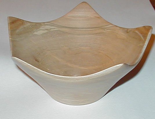

Nothing fancy, just a first attempt at something new...
Nice job, John. I know this sounds crazy, but ... can you tell me how it felt turning it? Did it seem much different than a round bowl? Any knuckles get in the way?

I didn't think so...the wood doesn't have red stains [}:)].
Kidding aside...it is a nice piece and a definite knuckle (or whatever gets in it's way) buster. UNLESS...the design is added after turning...which I think is very doable with a bandsaw and will be the route I'll take if I ever attempt this design.

And yes, for me it took several attmepts and most of the day to get the 'wings' even close to correct. I am normally a fairly aggresive turner when it comes to bowls, but with this it is a _very_ gentle cut out on the wings.

Ever thought of doing the cutting AFTER the bowl is turned? I feel it will be easier that way but I may be mistaken.
Once you figure out how to cut the 'wings' it really isn't that hard, just lotsa practice like everything else.
Bandsaw might work if both sides were even, like a square, not sure how that would work with an uneven amount of sides though. Course me and my bandsaw aren't exactly best of friends sometimes.
