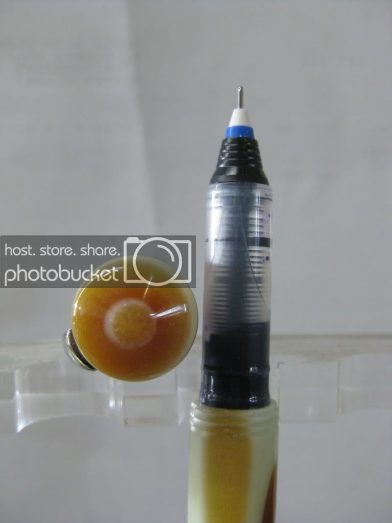

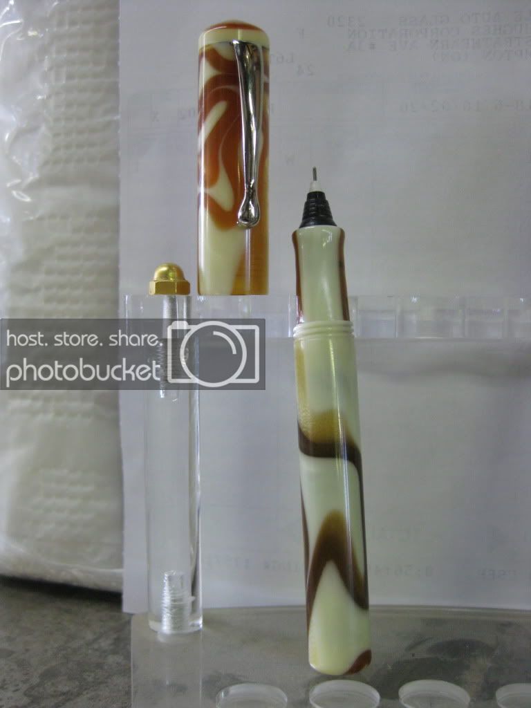

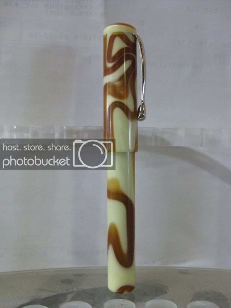

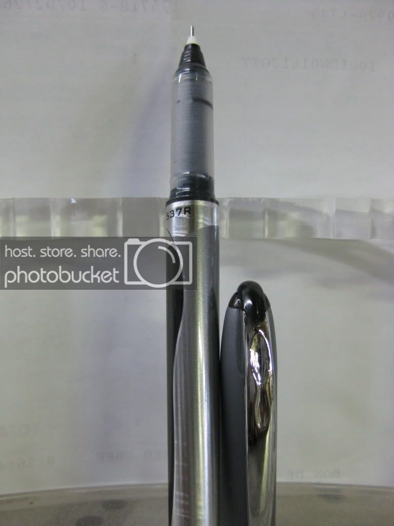

I love how these pens write but not to happy with the housing.

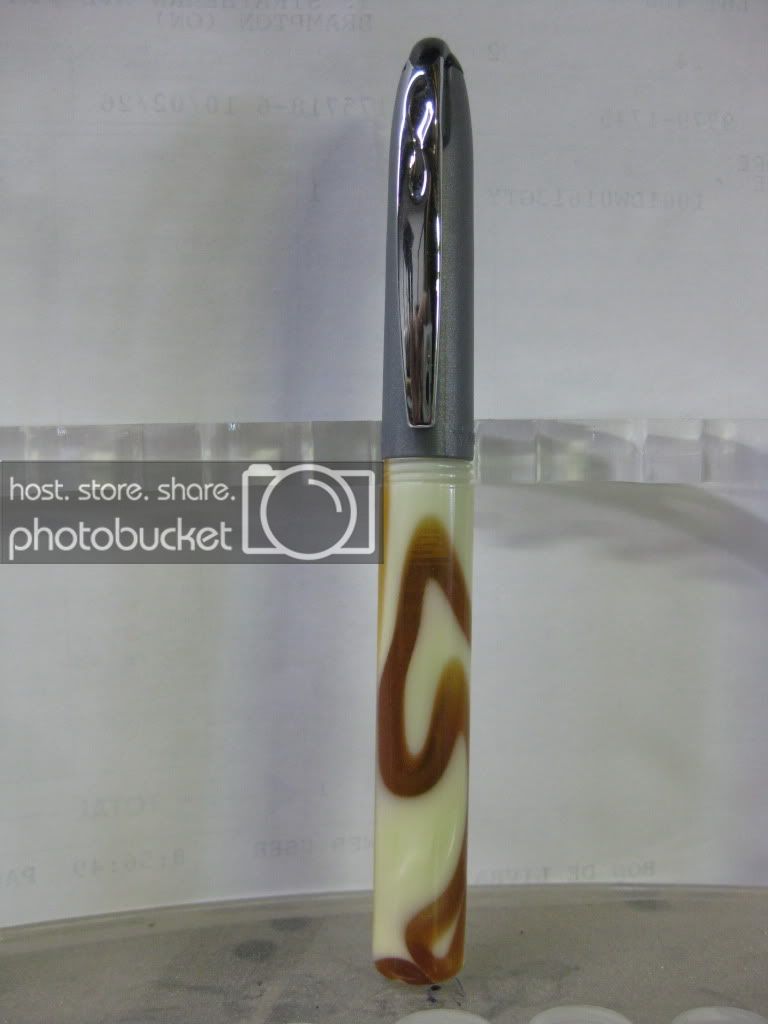

So I built a new body that I was going to make the matching cap but it looks kind of cool with the factory cap on it as well.
This body is threaded so I will make the cap but who knows for the future.

That is one cool looking pen. Did you just slide the whole stock barrel into the new PR or crack the exist housing off and just use the guts?

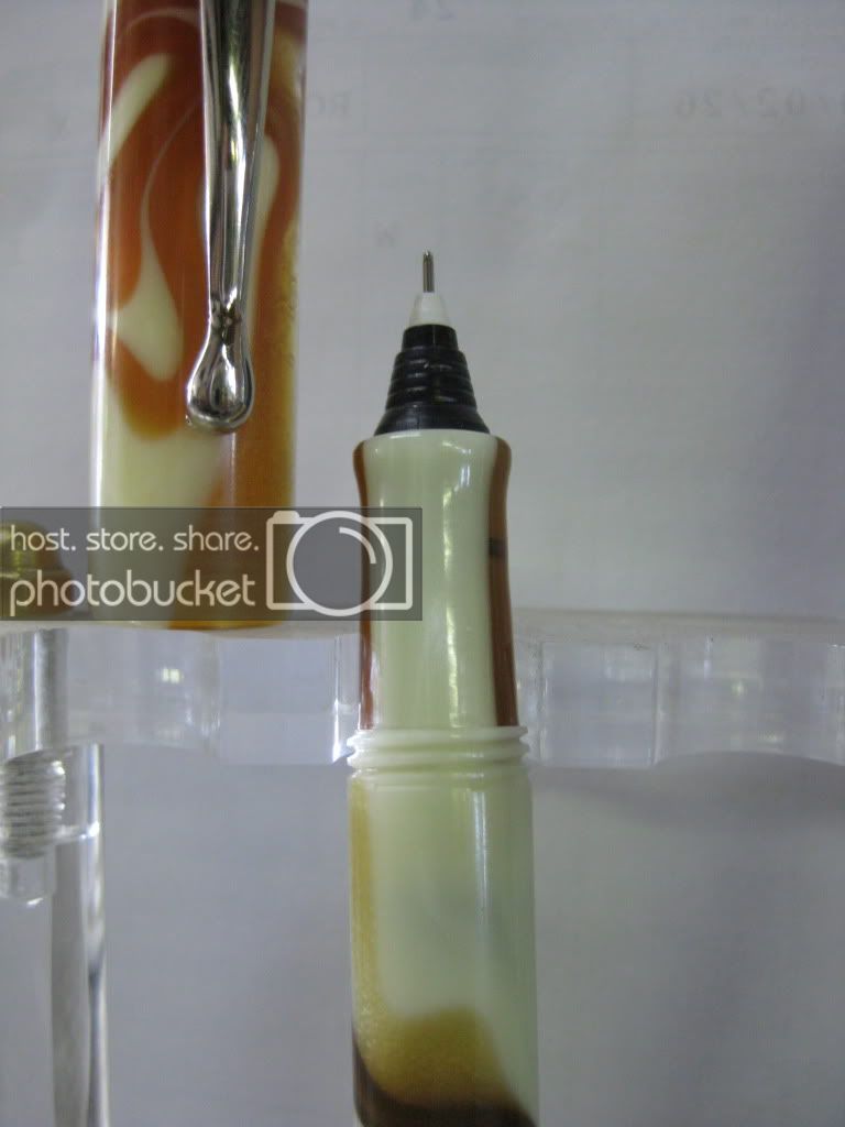

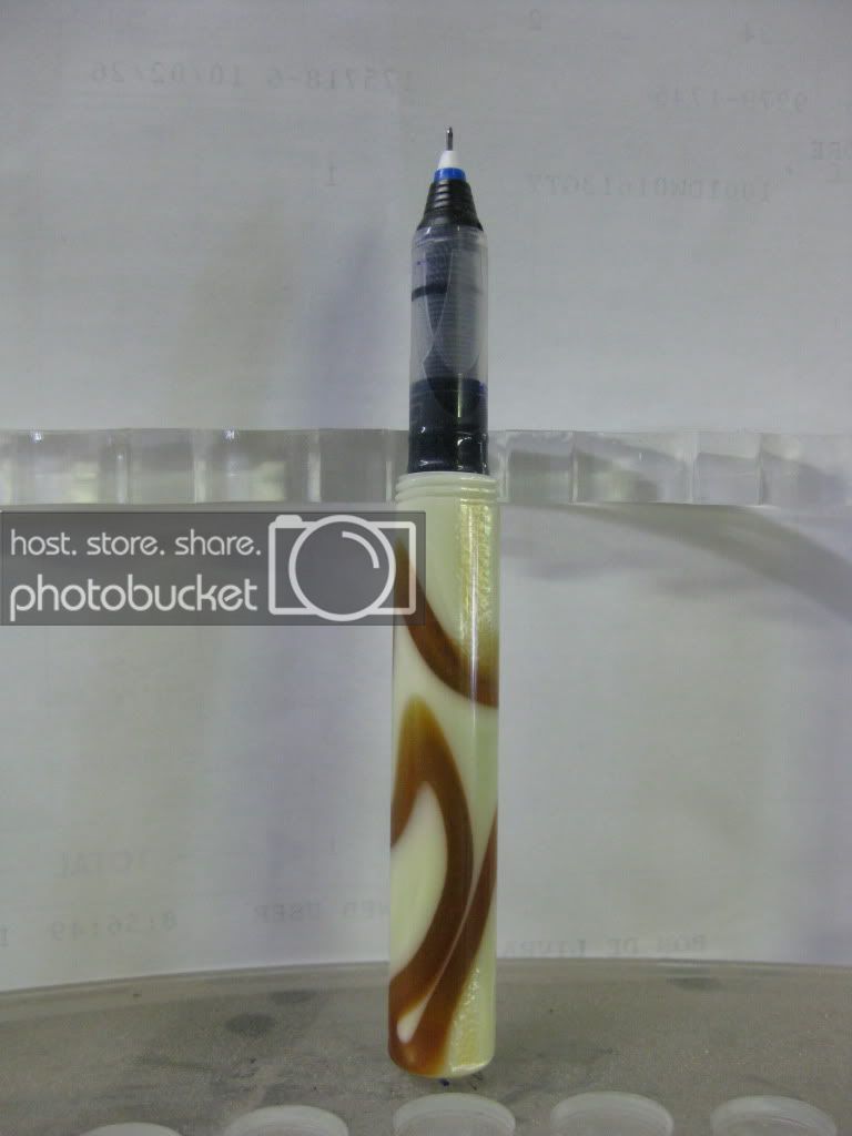

Well I will not admit it to any one else but what is on Penturners stays on Penturners right.
In the process of turning down the body it came unscrewed and it has it's own little refill unit. The threads were close to a M10 x .1 so with a quick run of the die they were now true M10 x .1. I then built the rest of the body like I was doing a fountain pen section with a attached converter and here is what I ended up with.
I am going to be doing some to give away at my pen breakfast so I have come up with some scraps that I will make the body out of and keep the stock cap on them similar to the Lamy body's that I do.
