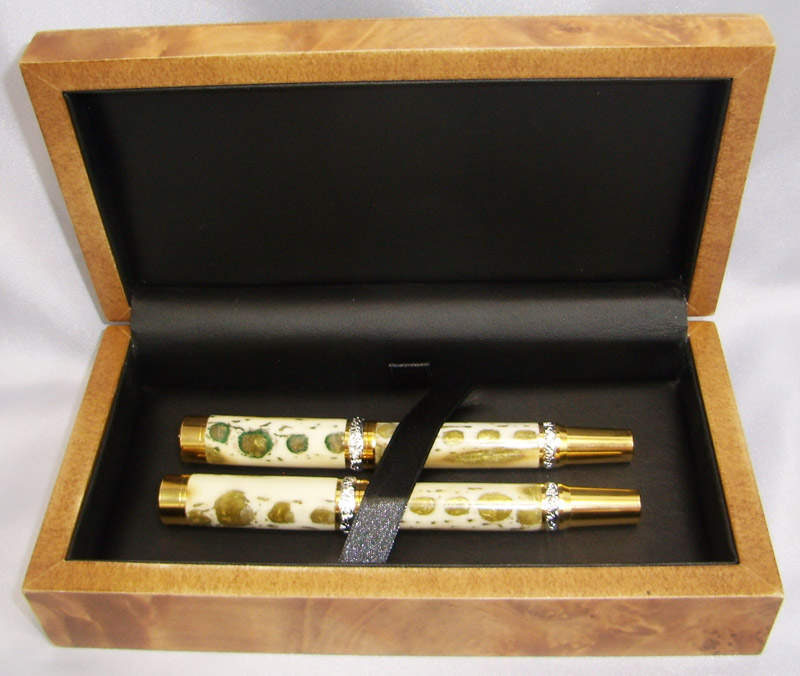

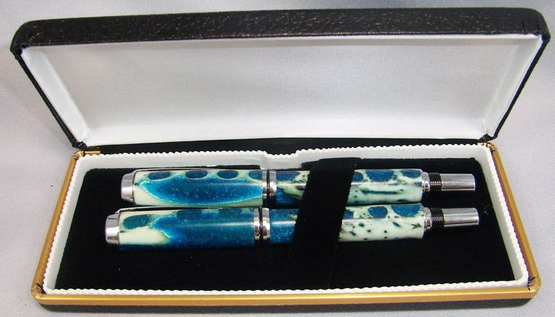

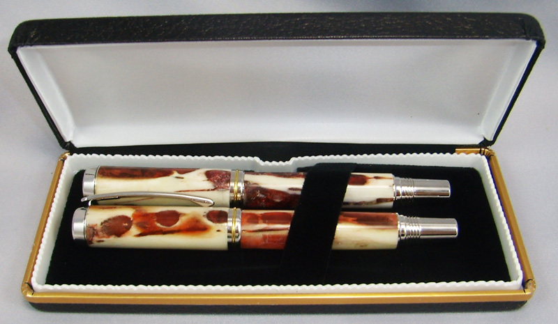

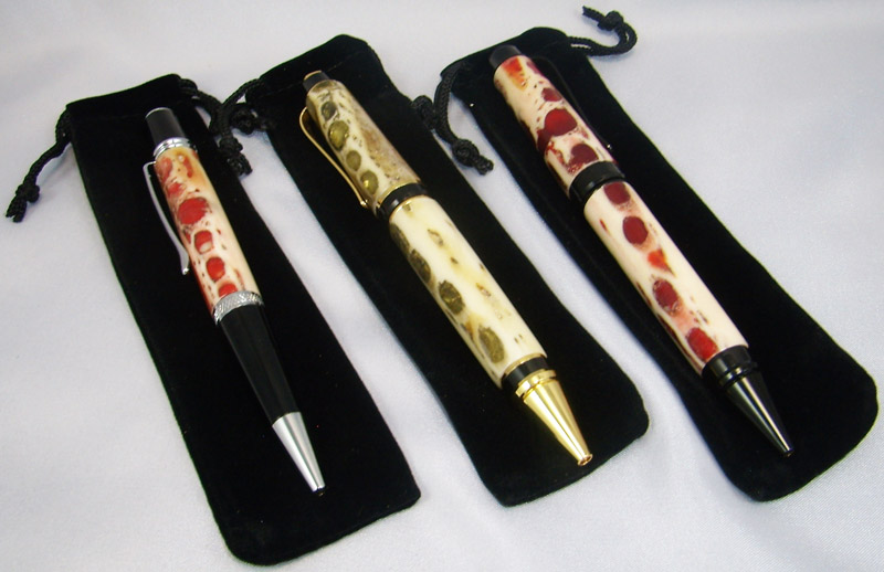

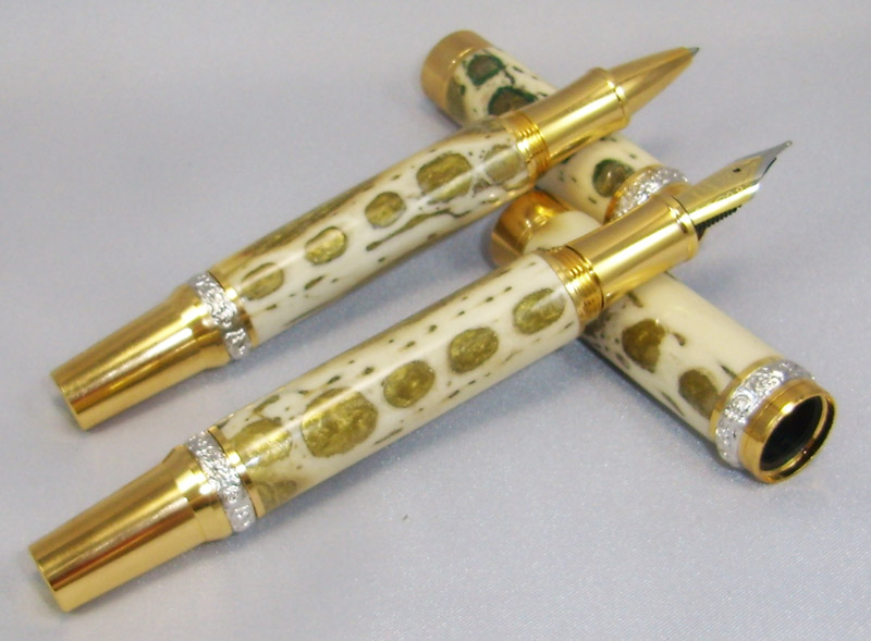

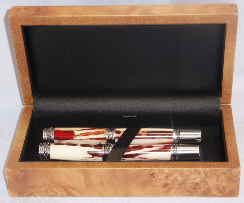

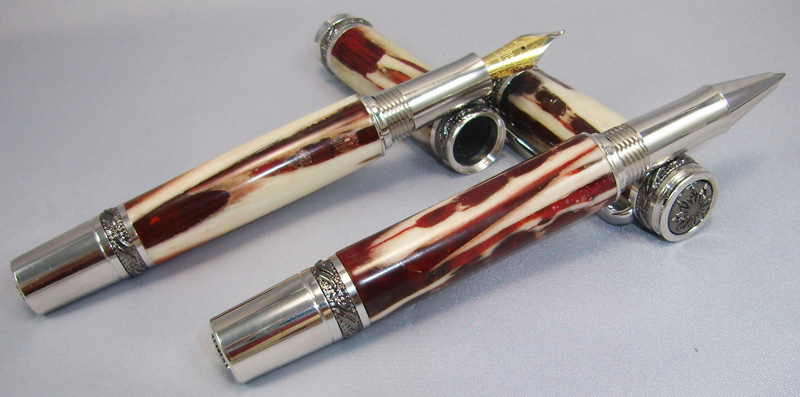

- Black Ti Majestics (these are really big and heavy
) made using 2 jaw pieces due to the large tube sizes and red blood resin

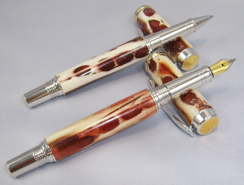

- Gold Ti Roman Harvest with gold resin (advertised as gold fleck, but obviously containing more copper than gold
- Rhodium GR Gent II with blood red resin

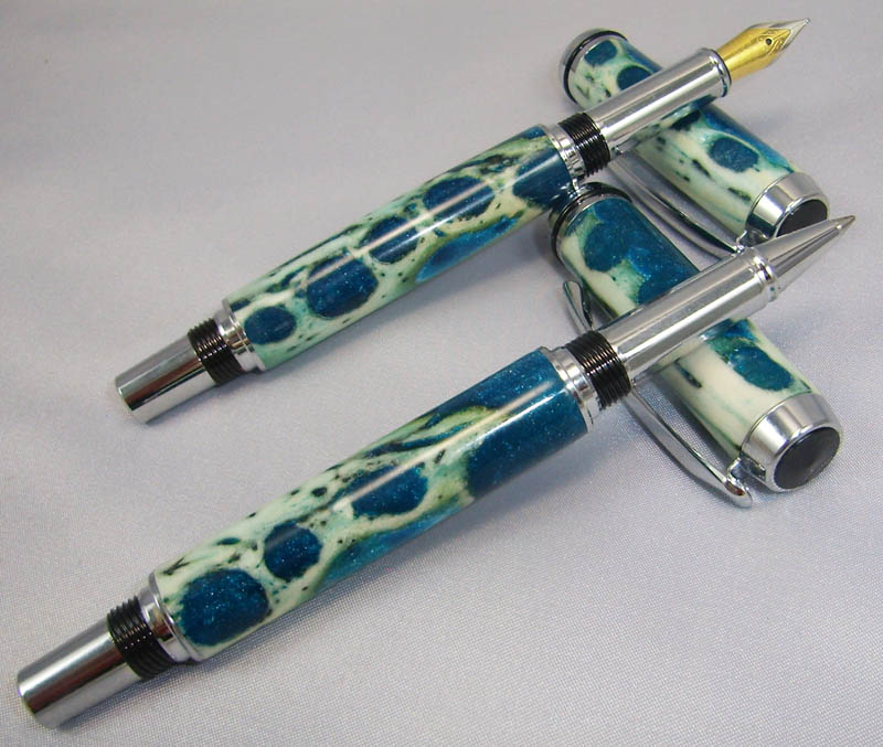

- Silver Baron with blue resin

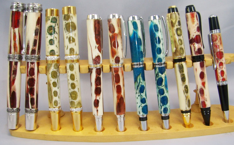

- from previous gold & blood red filled Cigars and Sierra
All finished with CA as above and are worth $1440 to me, probably going to be a lot more to buy from farm shop :wink: Got to get myself a decent camera, I hate the way the finish looks flat not shiny, they all have a very deep and shiny smooth finish.
