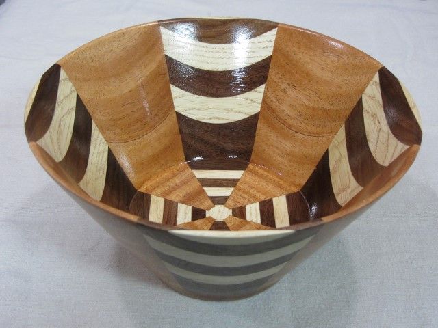

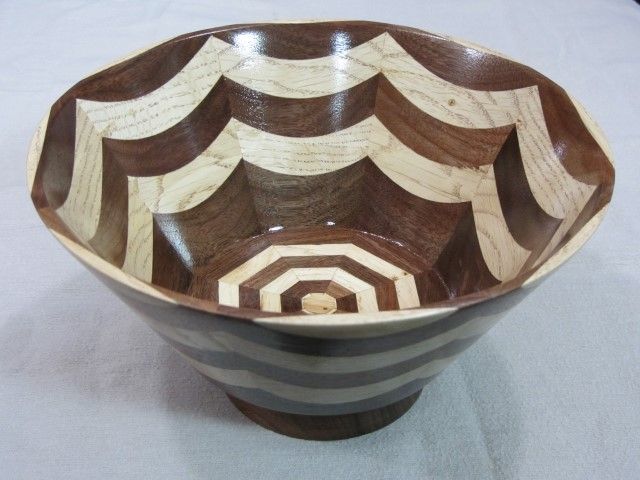

Your bowls are always stunning. I'd like to see before & after pictures if you don't mind sharing the glue ups.
You segment guys are rock stars!! No doubt after the 1500'dth piece it's easy by now...I'll live vicariously through your efforts and give you a huge pat on the back!!
William those are nice looking bowls. Did you use your Ringmaster to cut the segments?
The RM was just used for cutting the rings from the flat board.
The segments were cut on the Compound Miter saw .
Thanks to all for the replies .
When I first took the pictures I showed them to my wife and sister in law . later on after the finished had cured somewhat I brought them in the house and they both said . . WOW . . they look a lot nicer in the hand than in the pictures .

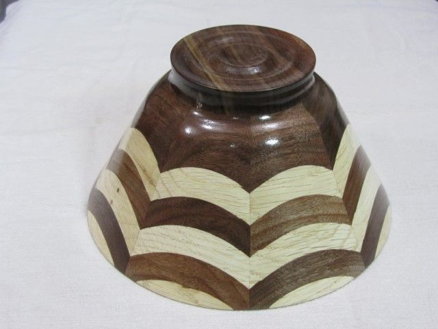

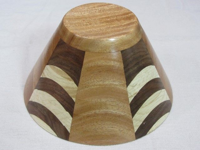

You certainly got those bowls down to perfection, one of the things I like the most is that you are taking some extra attention and work to what I didn't like about these type of bowls, and that was the hole at the bowls bottom, showing from both ends. You have certainly took notice to some of the comments made in that regard and solved it in a very smart way, buy creating patterns that allow the hole to the closed with a round piece of one of the woods used, making if look that it was supposed to be there, in the first place.
The other aspect was hiding of the hole from the bowls underneath, by gluing a extra flat board/layer, finishing it a lot nicer, in my opinion, obviously...!
Good job mate...!

If boards are just laminated face grain to face grain I only use plugs top and bottom .
When using segments , the glue surfaces are partially face grain and partially end grain because of the angle they are cut on . I usually (but not always) put a solid foot on the underside of segmented bowls because if I posted pictures of bowls without a solid piece over the segments , on a couple sites , a few members would throw a hairy fit and tell me it is going to self destruct and split and warp and crack and all kinds of other scary things due to wood 'movement' . :rolleyes:
With that said, I have glued up segmented pieces for the last 20 years without a solid piece covering them and never had a problem .
They are right if not using properly cured wood or using a poor grade of glue or not applying a good finish or if subjecting the bowl to extremes of hot or cold or too dry or two damp . .
But . . . . with properly cured wood and Titebond 111 glue and a couple applications of shellac sealer and a few coats of a good hard film finish , I don't believe anything is going to self destruct in most peoples lifetime .
