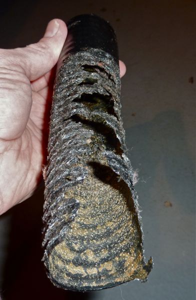

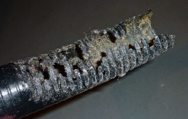

We have a built-in, salt-water fish tank and to make things easy we plumbed under the house using flexible PVC pipe. A couple of weeks ago we noticed our salt-level was VERY low. Since the only thing that can do that is the loss of salt water we went looking for leaks. I found where a rodent had nibbled a pin hole in one of the hoses. We shut down that line and figured we'd give it a couple of weeks to dry out under the house before crawling back under there to fix it. Opened it up today and it was even wetter. The rodents had chewed a hole in another line!! And that line that no longer had water spraying them in the face?? Well, that was quite the tasty snack!!

Copper would have been my first choice. But we have a live-reef tank and copper will kill all the corals.
Do you have references for the "special pressure pvc"? I'm going to have to replumb this this thing so finding a good solution is important. I only ever want to have to plumb it twice. :rolleyes::curse::rolleyes:
Try wrapping them in tin foil I believe that keeps them from chewing.
Great minds think alike. I used the thick metal ducting tape. And then 1/8" wire mesh like a cage around where they were eating the pipes. Since I found the issue I've been thinking of buying a bunch of aluminum window screen, cutting it into 2-3" wide strips and then wrap each hose in its entirety from end to end. It will be miserable work but better than dealing with an empty fish tank in the future.
