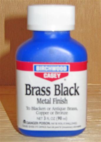

I'll be using black tubes for the GD, BF, and the BC.
I blacken the tubes using the liquid pictured here.
attachment.php
A reply from Dawn has convinced me to paint the tubes blue for the Ancient Mars blank. That's a suggestion I would never have thought of myself!
