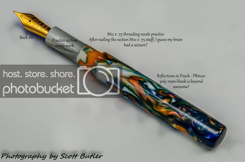

My question(s):
#1: What is the outside diameter of material you leave before using a die?
{example: M12x.75 single start die}
**Is it 12mm plus the .75mm equaling 12.75mm(0.50195 inch)(or as close as humanly possible using a wood lathe and free-handing tools)?
**Just 12mm(.4724 inch)?
**Or something else?
I have nice clean threads using a 7/16ths(.4375 inch) drill bit and my M12x.75 tap, but I'm constantly ending up with way too tight to fit, or way too loose to engage threads....either is acceptable(at least for me).
It would be really awesome if someone had a search engine that would give me the chart for all my taps? But I haven't found much information about the outside diameter of anything.....anywhere.
Scott (maybe whiskey and math is a better idea) B

Outside diameter of this was 11.8mm before using a M12x.75....thread were barely noticeable. And no, they did not break off.

This will sound silly, but make sure you're starting with the die facing the right way. The text on the die should be face out as there is typically a lead in taper that will center up the die on the tenon. I've left "threads" like yours if I accidentally tried to run the die backwards.
I shall make sure to 'face them', but I do think the lettering was towards the cut. But like everything else.....the more you think about it, the less you remember.
