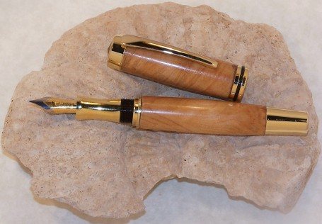

Marilyn, seal the ends of some chunks with wax or anchorseal (best) and leave them in a dry area of the shop or near your hot water heater if that is practical for a couple of months. Cypress loses a lot of weight as it dries. If his tree has any cypress knees, grab them, they are like burl sometimes in their unique grain patterns. The attached pix is a cypress knee pen I made some time back. I could not believe how much weight the knees lost sitting in my shop for a few months. Welcome to the addiction.

Thanks for the tips and for sharing your experience in this matter. I "nuked" a few blanks yesterday and have some others in a slower drying process. I've got enough of that cypress that I can play around with different approaches - my shop is now home for a science experiment! [;)]
The photo you sent, William, is inspiration to work with this species of wood - thanks!
