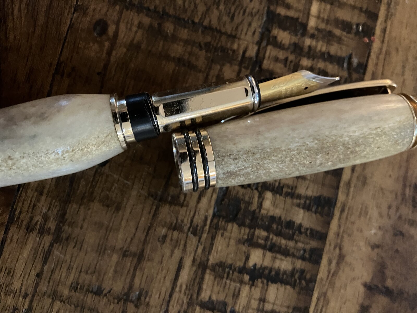

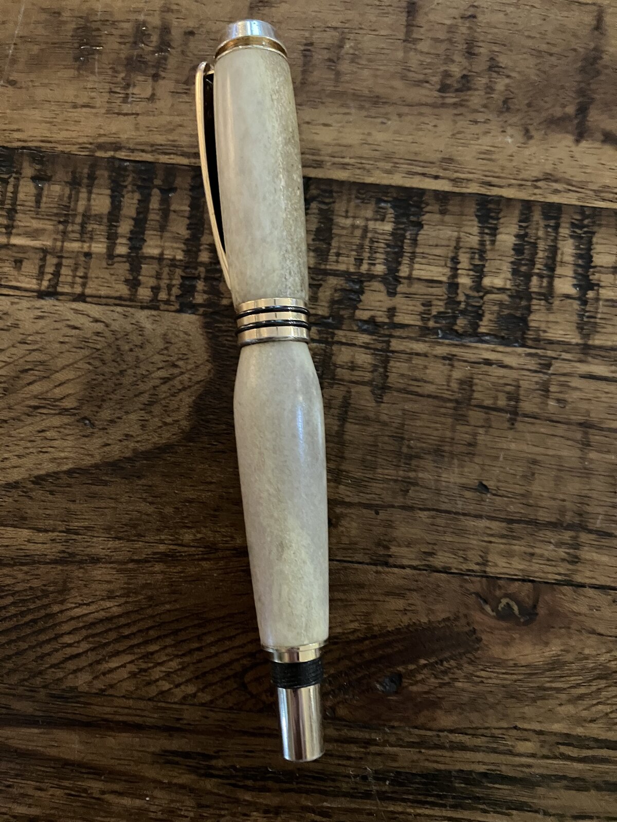

A former customer brought this pen to me this past weekend. I don't recognize which kit is and it is not one I made. He said he didn't remember who he bought it from and asked if I might be able to repair it. I told him I'd see what I could do. Can anyone identify this kit?
The plastic threads have broken off the nib. It appears to be the same size as a Smitty's Caballero fountain pen but the threads in the plastic nib coupler don't match, but the tube ID seems to be the same. I tried knocking it out with a transfer punch but no luck. Who ever made the pen must have glued it in.
Before I try drilling it out to replace with Caballero parts, does any one have any suggestions for removing the coupler section?
As John Said; it is indeed a tycoon. And the FP is "In Stock" If this is a variation of the Baron, the nib barrel end cap (Lower cap) should unscrew. Does the nib section unscrew? That would be the only way to refill the FP. If so, use a punch to punch out the (Lower cap). You should then be able to punch out the (Coupler) and remove the (Coupler Band). I have done this on occasion to the centerband. But if glued, may not be possible. If the nib section unscrews, Insert a narrow knife blade / rat tail file / triangle file inside the tube and score the inside of the black coupler until it can be peeled out of the tube.

Randy, it is definitely glued in. I tried a punch and hammer for over 10 minutes and it did not budge.
I'll contact PSI and see if I can get just the plastic inserts or if I have to purchase a complete kit and then contact the customer with the cost and see if he wants me to continue before I try removing the coupler by destroying it.
