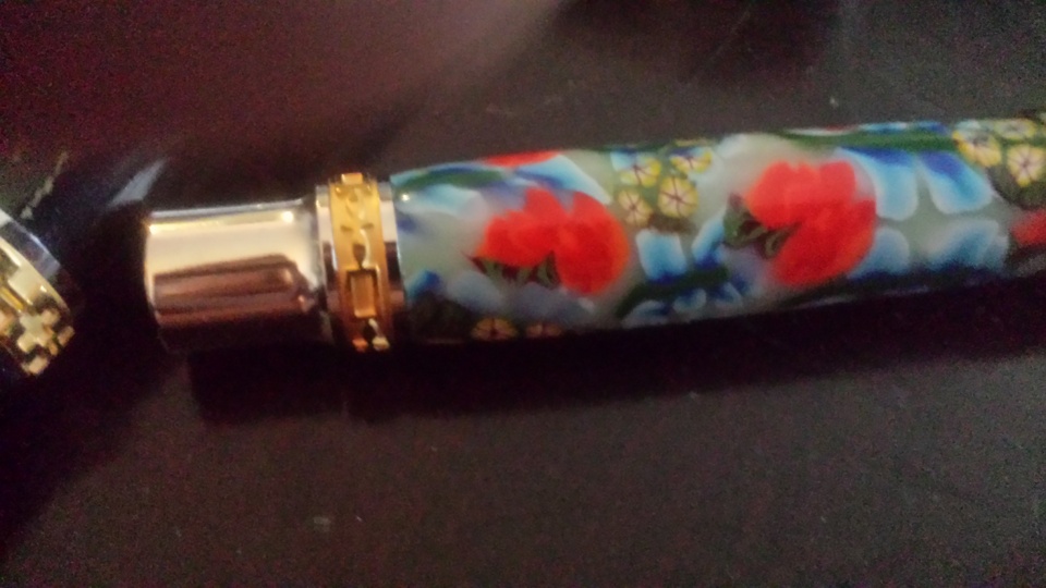

I recently put this pen together using one of tonis blanks.
It does have a CA finish. The flowers have blurred since I finished the pen. My thought is that I did not allow the CA to out gas long enough before packing it up in the zip lock bag to pack and ship.
What are some thoughts as to why the clay would have blurred like this.
Thanks for your suggestions.
Kevin

I've never experienced this issue with Toni's blanks, are you absolutely positive that these are her work? If so, then my next question would be, is it possible that you sanded/turned(whichever is the case)the blank too far?
In dealing with any pen that I have applied a CA finish to, once it is complete i have never had this happen. I wonder if it was the type of CA you used. I use the E-Z Brand(Monty used to sell it) and the stuff from hobby lobby as well.
Did you wet sand right after applying your CA finish ? If you didn't let the CA cure long enough moisture could have found a way to creep in somehow and fog up the blank.
Thanks for the ideas all. But I only sanded the barrel lightly to even the surface out. I use the E Z brand of glue like monty sold. I can tell if something got underneath because I don't have the pen in my possession. Only the red flowers have this appearance all the other smaller flyers
Flowers are fine. I'm starting to think I simply don't remember the original appearance of the red flowers. I have a terrible memory.... I looked at an original picture of the pen right after it was turned. It is pictured with this group of pens located towards the middle. After taking a closer I think the red flowers might have been this way the whole time. Thank you for your help and suggestions.
Several things here.
First I am almost certain is not made by Toni but for the problem mentioned that is irrelevant and need not be the focus of the thread. I would rather try to focus on what can be done here and help fix the problems rather than point fingers and play the blame game.
CA can cloud, it can crack it can turn fuzzy and other nasty things to. Since thin coatings that are needed for these blanks things like residue and non-polished surfaces can do that same thing.
The best plan of attack is to disassemble it, remove the finish and apply a new finish. Then wait a day or 3 before reassembly.
As for memory goes this is one of the key reasons to take photo's of the items before hand :) that will give you a reference point to work with. :)

I'm still not convinced that its a CA issue. If it were, then the issues would not be restricted to certain colors on the blank. It is my opinion that removing the finish and re-applying will only make the blank worse.
Good point there Seamus,
I should have ask, first, if there was anything that barred disassembly of the pen. If there were then it would be cheaper to buy a new blank and start fresh. Have to weigh in the cost but generally the more $ the pen is the higher % of repairs.
I have seen, recently in fact, cloudy fuzzy CA finishes over polymer clay pens. The polish itself on the CA was not that good.
Restricting to certain colors could also mean some reaction with something in that specific cane.

I can tell you for certain that the CA did not have a negative effect on the red flowers. The photo of the "unfinished" blank shows all the flowers look the same as on your finished pen--which is pretty much how PC works. The red flowers are an impressionist poppy-sort-of-thing, and they finished as they started.
I'm sorry the blank didn't turn out the way you thought it would. However, because we believe in excellent customer service and because I want everyone to be happy with the blanks I create, we have already offered to replace this blank. Please let me know if you have any other questions or concerns. I would be happy to help clear things up. :smile:

To date the only issue related to CA that I have seen has been more of a hazing due to things like contamination and finish. A satin finish type vs a brilliant shiny finish for example, a weak micro mesh finish can yield a satin non-glare finish of a type. These do degrade the visuals in the tube.
I also have heard (need some caster to step in and confirm this please) that some colors can cause problems/reactions while casting as well but that is not quite the case here.
CA does often have the opposite effects, it will remove things from the tube you may want to see, dips, seams and the like for example.
Looking at the finished pen it looks as if there is a haze over the entire pen. The translucent clay in the blank makes it look more dramatic in some areas. This leads me to think the issue was with the CA or the application of. In my experience clay has never reacted or blurred in reaction to CA being applied. It seems like it was a bigger deal to figure who's it was than to figure out how to fix it. If it were mine I would remove the finish and start again (what do you have to lose). Be careful removing it though as you don't want to sand or turn through the design.

It could be intentional, it could be contamination, it could also be problems with the clay or techniques used. It could also be a good amount of other things as well.
Also if we look closely one of the poly clay master has this to say on the subject.
This haze is what I first picked up on. However I would like to go on record to say that there may not be a haze. It may be a projection from the camera due to light levels, shadows and various other aspects like noise, distortion and the like. This is one of the key reason I do before/after shots as you will be unable to clearly see changes that does happen. I have seen a good number of haze problems happen and it's not that hard to correct that problem.
