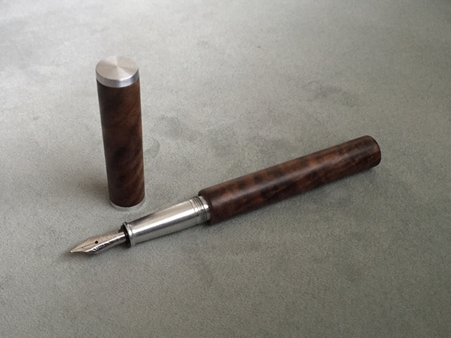

I'm making a kitless fountain pen for a friend from stabilized cherry burl.
My original plan was to make a liner for the cap from ebonite or alumilite to protect against the inevitable leakage from the nib that will find its way through the probably inevitable voids in the burl. In the meantime, I was planning to leave the interior of the barrel unprotected.
The, dangerously, I had a thought. "Is burl generally strong enough for a 14mm diameter tube with a 2.5mm wall thickness?" I think that I could easily do it with straight grain, but have no feel at all for the stabilized burl.
Any thoughts or educated guesses?
Thanks.
Bill

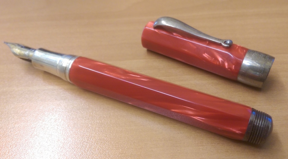

That's not the only way of making a cap postable. You could thread the end of the barrel and the cap could screw onto it.
Here's an example -- my Montegrappa Symphony pen:
Duncan,
I've thought about that, and may actually mock it up and go that way if I can shorten the section and bury the cap threads deep enough.
I guess I'm just spoiled by vintage and high end pens whose lengths hardly change when posted. (Don't get me wrong, I know that the Symphony is both vintage and high end and having seen yours, I now want one. Maybe at the DC or Ohio pen show this year).
Pelican does something similar with their piston fillers in that the filler knob is just slightly smaller in diameter than the barrel so that it fits inside the cap threads which are buried close to 1/2" deep inside the cap.
Thanks for the tip.
Bill
