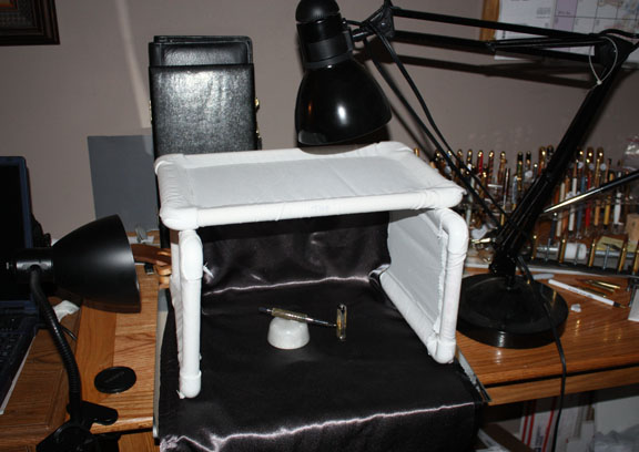

Well, I put together a quick photo-tent today. I made it out of 1/2" PVC and wrapped the sides and top with some light fabric (believe it is muslin cloth).
I have two lights. One on the left and one on top. The one on the top is moved to the right of the top to give better light distribution. Both lights are 40W each. I think they will take larger bulbs if that is necessary but I am not certain that it is. I have a little photograph experience but not as much as some, especially at taking pictures of pens. :biggrin:

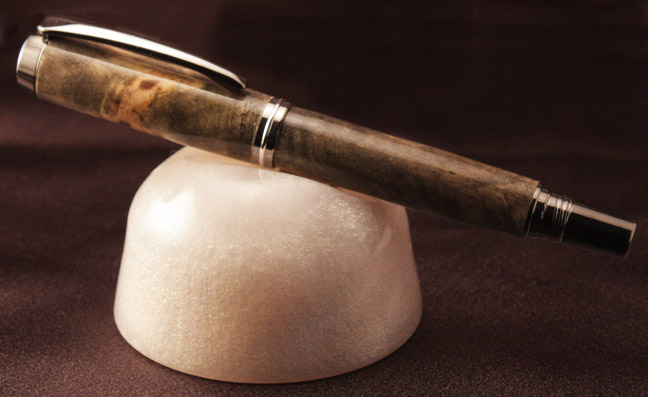

Any input on the picture? How about the stand? Background?
Please help me get better.

Background is ok.
In a photograph, you eye tends to go to the brightest item. In this case, that's the white stand. If you used something darker, that would force the viewer to focus on the pen rather than the stand.
What is the stand made from? Can you paint it a darker color?
Background is ok.
It is just a chunk of PR in Ultra Shimmer. Shaped and sanded to hold the pens.
I think you'd be happier with more power. 2 x 40 watts isn't very much light,
even that close. Compare to a studio that might use a multiple lights of
200 or 300 watts each (although probably a bit further away) and a lighter
diffusion material.
You're softening the lighting very well.. now you just need a bit more of it.
FWIW, you could probably do it with these lights, but you'd have to open
up the aperture (or slow down the shutter speed or both) and that will affect
your depth of field.

The base is way to large. The subject is your pen and the base it is resting on is as large if not larger than the subject. If you have the ability to crop images you could cut off most of the base. Additionaly the lighting is not even. The right side of the pen is in shadow. Reposition the main light (the one on top) to give you a more even light across the whole length of the pen. Then use your fill light (the one on the left) to open up the shadows. Since both your lights are the same you can move the fill in and out to keep the image from getting too flat.

Thanks for the input. I might have to make the stand a bit smaller and darker.
Can you explain in different terms what is meant by "open up the shadows"? Does that mean get rid of?

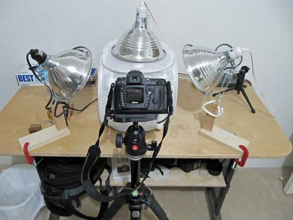

Here is a pic of my setup.

Photographing pens is an exercise in portraiture - the good news is that the pens won't complain about how long you take and how uncomfortable the pose it. The bad news is that they are small, so you have issues with depth of field and exposure.
I don't think the example you have provided is all that bad. The two suggestions I would make are:
1. Find a different support/stand for the pens. Something smaller and darker so that it doesn't detract from the pen itself. I've seen pen pictures made with stones that worked very well. I normally use a wine cork that has been stained a dark brown. Anything but white.
2. Play with the light a bit. Boz suggested opening the shadows - I agree that the area behind and to the right of the pen in the illustration is too dark and needs to be lightened. If the set-up picture is representative, the placement of the lights explains the problem. The light on the left is probably ok, but the top light should be moved to the right and perhaps back. If you are working in digital, do a series of test images with that light in various positions while holding the left light in one place. You want 'modeling' (ie, you want the image to depict the shape of the pen), but you also want to even up the lighting just a bit.
I wouldn't worry about whether the bulbs you are using are too weak. Because pens are inanimate, if your camera is on a tripod you don't really care how long the exposure is. I think you can work with what you have - you just need to fine-tune the setup a bit.
I'll work on this one tomorrow maybe. I just like the perch....It sets it up off the ground. Personal preference but I will make a darker perch.
Thanks for the recommendation. I will try that tomorrow. I am working with a Canon EOS XSi DSLR.
So what I gather from your last comment is you think the pen is too two dimensional and you can't really see it in three dimensions. Is that right? So, if I move the top light down to the right rear, that may create more depth?
As far as depth of field. Should a larger apeture (smaller opening) be used to get more depth of field or since there is a single piece being photoed does this not matter?
Yes, a larger f-stop(f/11 vs f2.8) will give you more depth of field. If you need to find out exactly what you'll be working with, try this: >>>>DOF Cal<<<<
Your pen is very 3-dimensional, if it wasn't-it'd be a PITA to hold....and your light tent will let you see that in your photo's with some adjustments with the lighting. Good thing digital film is cheap!!! Take a lot of photo's, look at your EXIF data and then keep doing what works.
Scott (smaller stand, nib somewhat toward the lense) B
