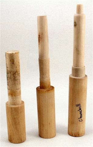

Jim,
Here's a picture of three of mine. The two on the left were made for a double closed end El Toro and the other was for a Churchill. As you can see, there isn't much to them. If you had some Corian, you could make some that were more durable.
You got it, Jim. On the Churchill model, done after the others, I turned a shoulder that's about .020" bigger than the diameter of the bushing that would normally be used there. On the El Toro, I was stopping every minute or two to measure. The shoulder makes it go a lot quicker.
