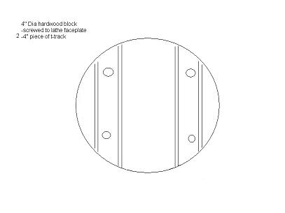

Here is the base. A 4" Dia. 1" thick piece of hardwood screwed to a faceplate with two grooves routed in it to hold pieces of t-track.

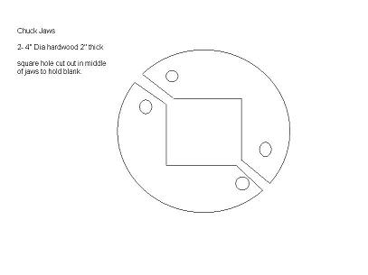

Here are the jaws. 2 pieces of 3.5" dia hardwood 2" thick with a square hole cut out in the middle that is just slighly smaller than 1 1/2" square. I think I will make one side non-moveable and the otherside moveable with some adjuster knobs. Just have to make sure I get them centered so I can drill centered.
