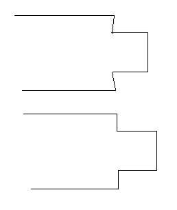

If you are making a tenon for the center band of a Euro style pen. Here is a little trick if you have trouble keeping it square.
<b>Image Insert:</b><br />
<br /> 4.37 KB
You can actually agnle it in like the top drawing (the angle is a bit exagerated for explanation purposes). This insures that the outer edge of the CB meets the outer edge of the wood without creating a gap.
