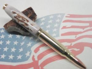

Of all the pens I've made, I have never made a rifle casing pen. Don't ask me why:rolleyes: I just never got around to it.
However, I have a friend who is a serious, serious hunter (the kind deer have nightmares about..... and he talks like Carl Childers on Slingblade, lol).
I owe him a nice favor, and would like to make him a shell casing pen.
If you have any links to what shell casings fit what kit, or if anyone has such info they can share with me, I would appreciate it!
The pen will be a shell casing and antler provided by him. He has every rifle imaginable, so I'm sure he'll have everything laying around, other than maybe a .50 cal., lol.
The simplest calibers to start with are 308 Winchester or 30-06 Springfield, which lend themselves for use with a slimline or euro kit. Are you planning to use a kit nib? If so, 308Win is probably the easiest. If you want to drill a bullet for the nib, then your options increase greatly. I've made pens from 223Rem, 243Win, 30-30Win, 30-06Spg, 7mmRem, 7mmRemMag, 300Winmag, and 338WinMag (et. al.) using a variety of kits including slimline, euro, perfect-fit, and cigar.
If you'd like, you could come over and I'll walk you through the case prep. I have the tools necessary to safely disassemble live ammunition, or to resize and clean fired brass. I also have 308 caliber bullets that are suitable for nibs. I can help you cut the cases (if you want that, and even powder-coat the parts. Drop me a pm if you're interested.

Matt, The simpliest one that I have done has been the 308 I actually use a slimline kit and the use the deer antler for the cap making sure it matches the dia, of the 308.
If I can help PM me and I`ll answer any questions that I can. Good luck with the pen.
