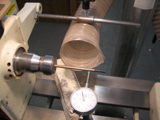

I made a trade recently which included getting a 14 x 41 Central Machinery (Harbor Freight) wood lathe. I have been using it to begin making pens. The good news is that I have found a hobby that I really enjoy. The bad news is the lathe just will not cut concentric. I have tried many different ways but the closest I have been able to get the headstock aligned is +/- .004. Is this the closest that I should expect or is there a method that will do a better job. I am using a dial indicator to check my measurements. I have been successful in getting it close a couple of times but it does not want to stay. This lathe uses flange mounted bearings. This means 4 bolts hold each of the two bearings in place.

Yes, I have brought the tail stock up to the head stock and also to the end of the mandrel shaft. Visually they look pretty close. Especially with just the head stock and the tail stock. When I back the tail stock off with the mandrel mounted, I can see a slight mis-alignment but not really that much. I used my dial indicator on the mandrel adapter at the headstock and measured +/- .004" for a total of .008" OOR. I have ordered a new mandrel shaft. But, I have been very careful not to over tighten the mandrel. The tail stock has a bearing with a live center. The bearing was a little sticky at first but it spins freely now. I was thinking I might have to build a steady rest to support the middle of the mandrel when turning 7 mm pens. That seems to be a little extreme but maybe I will need it. I have never used any of the mini-lathe from PSI or anyone else so I have no bench mark to measure from. I don't know and cannot find any specifications for any of the PSI lathes or for mine. So, I don't know what is considered within design tolerance.

Try one of these.......
OR, if your dial indicator has a magnetic base just use that. Rotate the lathe by hand to find the high (or low) spot and then tap it with a small hammer until you get it to within .001". It only takes a few seconds.

Yes, I have the magnetic base and dial indicator. The out of round is the headstock shaft. The +/- .004" is the measurement at the headstock shaft. The shaft is supported by two flange mounted bearings using 4 bolts each. I have literally spent hours and hours trying to get it down right but it never gets any better than that.

I have spent several hours taking all these suggestions and working each one at a time. I have found the headstock has some movement horizontally. There is a clip ring that should be holding the shaft in position but there is no groove for the ring. I have located a locking collar and ordered it which should solve the problem.
Next, I found the shaft is very close to tolerance when it is held in position. But, when I put the adapter to change the shaft from a 3/4-10 TPI to 1-8 TPI, I pick up a total run-out of another .007" - .008". That seems to add up to the total mis-alignment. It must have been there from the beginning. I wonder now if I can get PSI to exchange the adapter.
With the adapter and mandrel removed, I can put the center back on and pull the tail-stock up to the headstock. I can't see any noticeable alignment problem. I am having problems finding a way to measure the difference because the headstock center is made from hex material.
Like you said, all the mandrels have some run-out. I suspect this is probably true. I pulled everything up as tight as I could without the collar and I still see run-out but it seems to be greatly reduced. I am hoping that adding the collar will close the gap. Or, at least close enough to where I can make enough pens to sell so I can afford to buy a better lathe. :doctor: Guys, I am disabled and on SS disability. This makes funds a little small for hobbies. The wife says I can only buy another lathe if I sell enough pens to buy it. :frown: That sounds reasonable.:rolleyes:
