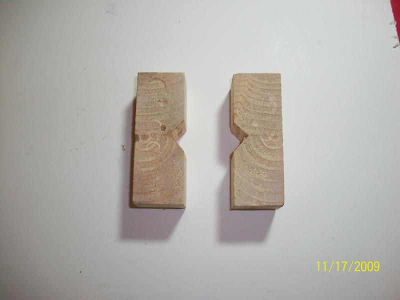

Here is a jig I use to center my holes for celtic knots. Drill the hole first, slide the blank on then run it through the band saw and the hole is centered then I make the cuts for the knots. Prevents drilling off center after the knot is done. It may work for antler but I havent tried it for that. You arent too far away if you want me to give it a try.
